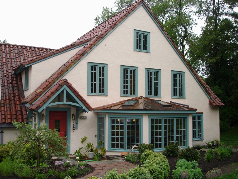

NOT JUST FOR CURB APPEAL. There is hardly a new feature that isn't both beautiful and functional. The new tile porch roof blends seamlessly with the facade while protecting the entrance from the elements; the large bay window adds space and plenty of daylight to the kitchen; the new garden is designed to help deal with stormwater runoff.
