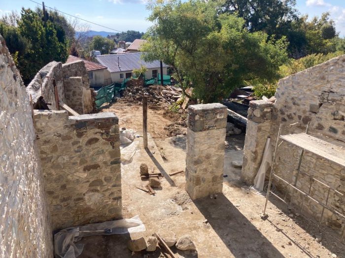

I am in the process of rebuilding the stone walls of an 1800s house in the mountains. As the temperature ranges from -10 Celsius (15 F) in the winter to 40 Celsius (105F) in the summer, I thought I should go for external insulation in order to achieve some passive cooling in the summer. I am also planing to install a new cathedral roof with internal reclaimed oak beams which would be visible internally and standard hidden softwood rafters with insulation between them. My questions are:
1) For the roof insulation, would 8 inches of rockwool between the wooden rafters be enough?
2) What would be the best material to eliminate the thermal bridges between the rafters and the internal cladding? Rockwool would be too soft and would collapse but stronger materials are not vapor permable
3) I was thinking of insulating the overground external walls with rockwool and a net system by Knauf. For the underground portion of the wall, I was thinking about 10cm thick reinforced cement, sealing membrane and 4 inches of extruded polystyrene, with gravel outside to drain any rain water. How would the between rafters rockwool need to run with the exterior wall rockwool so that I avoid thermal  bridges?
