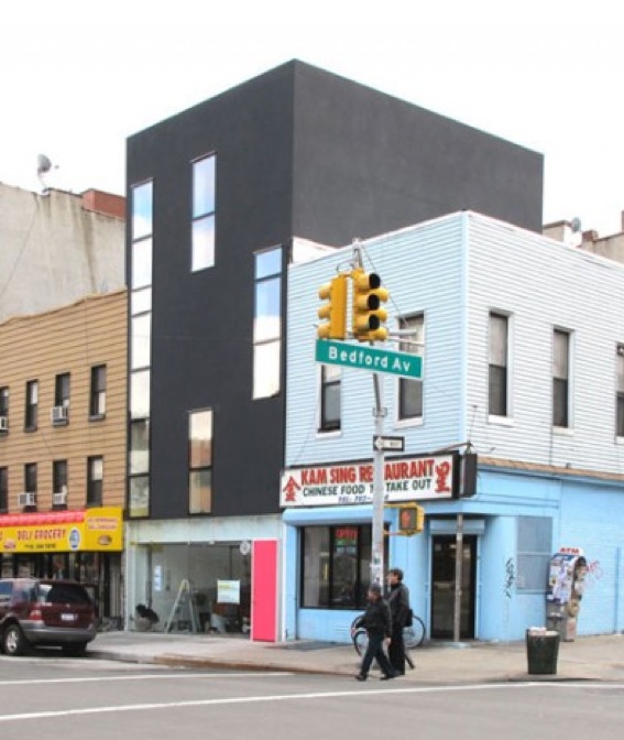

New York City Passivhaus. Completed last month, this mixed-use building in the Williamsburg section of Brooklyn, New York, was renovated to perform to the Passivhaus standard. It includes a ground-floor studio-and-retail space, and a three-bedroom residence above.

The building’s 8-in. concrete masonry walls were insulated with 7 in. of expanded polystyrene. The dark-gray exterior insulating finish system was added in the fall. Looking south from the first floor of the three-bedroom residence. The interior is designed to allow sunlight to fill most of the living area, including the stairways. An open, industrial-style design dominates the interior. A studio and retail space, operated by designer GGrippo, occupies the ground floor.
Last fall, the construction crew at 174 Grand Street in Brooklyn, a mixed-use building a few blocks from New York City’s East River, installed expanded polystyrene insulation on the exterior’s concrete masonry walls, and spent a lot of time double-checking for air leaks at seams and joints all over the shell.
The project has since progressed to completion, and its remaining air leaks are likely to be very few and far between. We say that because this renovation was designed by architecture firm Loadingdock5 to bring the structure – with 900 sq. ft. of retail-workshop space on the ground floor and a 1,500-sq.-ft. three-bedroom, three-level residence above – to the Passivhaus performance standard.
