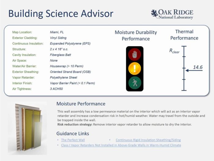

This is what Florida builders might see. When Building Science Advisor is up and running, a builder in Florida might get this kind of input. The builder enters the information on the left side of the screen (location, cladding, insulation, and the like) and the design tool predicts its moisture performance and clear-wall R-value. The builder could tweak the inputs to get a less risky result.

A builder planning a house in Maine, for example, could choose one of two cities as a starting point. After logging on, the builder would begin specifying building components — framing, insulation, and cladding, for example — and get an idea of how risky the wall might be. In the end, Desjarlais says the tool will treat systems “probabilistically” to give builders the odds on whether a particular wall system will result in moisture or other problems.
“No one else has done that in the past,” he said. “Instead of saying, ‘This wall passes and this wall fails,’ you say, ‘Eighty-seven percent of the time this wall is OK, and 92% of the time this wall is OK,’ and so you can give people a better indication of what how close you are to getting into trouble.
“Then, this is André’s vision, you can start playing some ‘what ifs,’ ” Desjarlais continued. “What if I get rid of this component and put a cheaper component in? My risk goes up by 5% but I just saved a dollar a square foot. It gives builders some useful information they can work with and make their own decisions. They can make the decision based on data as opposed to whim, or whatever.”
