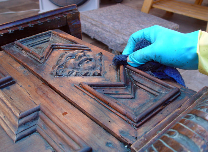

Paint and varnish strippers containing methylene chloride will be removed from the shelves by Lowe's, Home Depot, and Sherwin Williams. The chemical has been blamed for more than 60 deaths in the U.S. since 1980, but is still permitted by the Environmental Protection Agency.
