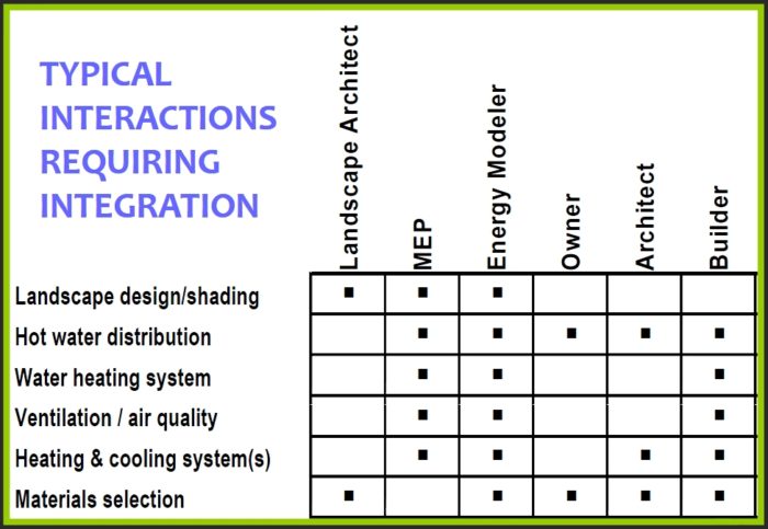

Communication is key. Your team needs to identify the systems, materials, and issues that will need to be addressed as the project progresses. The result is often a pretty comprehensive matrix; this sample is arguably missing some dots.

Rule #4: Establish Communication Protocols Early. As a team, identify the range of systems, materials, and issues that will need to be addressed as the project progresses, and the team members who should be involved in communications about each of these areas. Often it’s a pretty comprehensive matrix; the sample shown below arguably is missing some dots.
