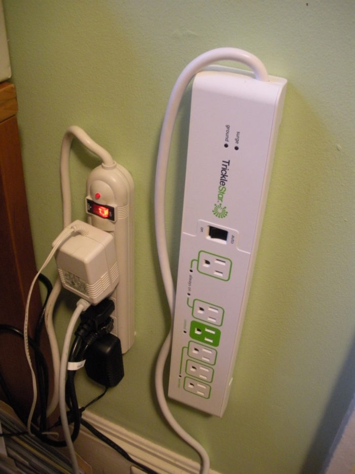

On the left is my plain old power strip, which I turn off when I am finished working. On the right is the smart strip, which I have yet to figure out how to integrate into my office arrangement.
I’ve been hearing about “smart” power strips for a while, and while I am pretty good about turning off the various electronics in my house on regular old manual power strips, I decided it was time to evaluate one of these advanced devices for myself. I purchased a TrickleStar unit for about $30 and set out to hook it up in my office to see how it worked.
The unit has two permanently on outlets, one “control” outlet, and three switched outlets that turn off automatically when the power draw on the control outlet is low enough to suggest that the main equipment is off or in standby mode. As I understand the way these things work, if you plug a computer or TV into the control outlet, when you turn it off, the strip recognizes that the power use has dropped; and while not turning off the power to the control outlet, it does turn off the switched ones, cutting power to peripherals such as printers, audio equipment, DVD players, and the like.
My lack of success
My office is small and crowded, but relatively simple. I have a laptop, a second monitor, a backup drive, and a set of speakers on one power strip, and my printers and a scanner on a separate strip. I turn the strips on and off manually when I use them, often several times a day, depending on when I am at my desk and what I am doing. Anxious to see how much effort my new smart strip would save, I connected my laptop to the control outlet, and my monitor, disk drive, and speakers to the switched outlets and went to work checking it out. I turned off my computer, and voila! Nothing happened. The switched outlets remained powered up. I took a look at the little transformer on the cord of my laptop and realized that it was probably drawing enough power to confuse the strip into thinking that it was still on. I unplugged the laptop cord, and the switched outlets turned off in a few seconds.
Interestingly, the switch on my smart strip doesn’t actually turn anything off; it just turns the switched outlets on if they are off. So, in order to take advantage of the product’s features, I have to unplug my computer. Seems more complicated than my current arrangement. I suppose if I had a desktop computer that drew no power when off, it would work fine, but these days most people use laptops, so the effect of smart strips is reduced.

    I just got one of these smart strips this week from the utility and it works great on my desktop computer setup. The speakers and two monitors all shut off when the computer goes into standby mode (presumably about 3-4 watts, though I haven't measured it yet.)
    Works like a charm, and is a great improvement over my use of a wall switch controlled outlet. I would often forget to flip the switch before I sat down to work, but now, I move the mouse and everything springs to life.

    With a laptop as your "desktop", it is advisable to use your monitor as the control. The down side of that is that if you are doing something that lets your monitor screensaver go on, or if you are going away for a while and turn off the monitor manually, everything shuts down. I had to learn that if I am doing a long print job, I need to set my power saver settings to always on. The up side is that I don't come into my study in the morning and find that my printer and my scanner, etc have been on all night.

    I bought one of these with the same idea, to try it out and see if it really would be an easier way to turn off all my computer peripherals - I have a desktop computer and mine works great. I have the computer, not the monitor, set up as the "control", and the speakers, monitor, and printer on the automatic settings. My desk lamp is in the always on setting. What I like about it is that even when my computer goes into "sleep" mode, the strip considers it "off", and everything powers down. That means I can essentially walk away from my computer, and my whole office will power itself down in a few minutes. When I come back, I just wake up the computer and everything springs to life. I realize this is probably not saving a giant amount of energy (the kwh kind), but your article seemed to address more your personal convenience part - of not having to worry about turning switches on and off all the time - and for me, it does actually accomplish this.
    Interesting that yours doesn't work with your laptop though - mine actually has some kind of sensitivity dial on it - you can adjust how little juice needs to be flowing through the master receptacle before the strip will consider it "off" - mine worked fine without messing with it, but if yours has a similar control maybe you could try fiddling with that a little to get the laptop to work with it. Just a thought.

    Try plugging in your flat screen, DVD player, Wii, and subwoofer into the smart outlets. The STB/DVR should be in an unswitched outlet. The reciever should be the activating device. If you set it up correctly, you can save money.

    I don't own any of that equipment. I have a TV and a DVR, period. My office has a speaker set, printers, extra monitor, etc. but the laptop transformer doesn't power down enough to activate the smart switches. No user error here, just someone who can't take advantage of the technology and is willing to turn things off.

    You can not plug any device into the control outlet that uses a "charging" transformer i.e. your laptop. The laptop charger has the same electrical load whether the battery is charging or not, whether the laptop is on or off. Bad choice for control.

    I bought a couple of these and they work fine. Mine have a sensitivity switch on the bottom - you should try adjusting yours. I like these products because with my pc and tv setups I like to have the cables hidden away (I wouldn't mount my strip on a wall like you have done). I dont like crawling under my desk to switch things off so I think these products are a good idea. My understanding is that the savings depend on how many things you have plugged in - the more you have, the bigger the savings.

    "You can not plug any device into the control outlet that uses a "charging" transformer i.e. your laptop. The laptop charger has the same electrical load whether the battery is charging or not, whether the laptop is on or off. Bad choice for control."
    This may depend on the laptop. My MacBook Pro charger shows considerable range of load from about 60W (charging + laptop on) to almost nothing (fully charged, laptop sleeping). The charging mode would buffer the switching though so the smart strip would not track exactly with the laptop condition and your conclusion is probably correct.

    some smart strips have a trim knob so that you can adjust how sensitive the control-sensor is.
