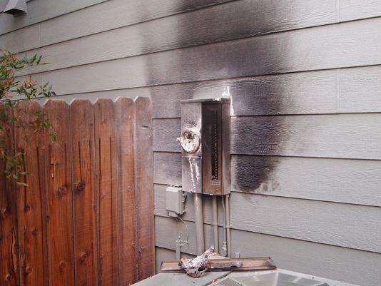

Reports of burned smart meters in Reno and Sparks, Nevada, prompted fire chiefs there to call for a safety investigation by the state's Public Utilities Commission. This photo was provided to a local newspaper by the Reno Fire Department.
The Nevada Public Utilities Commission has opened an investigation into the safety of smart meters after fire chiefs in two cities, Reno and Sparks, connected them to nine fires in their communities, The Reno Gazette-Journal said in a story posted on October 16.
NV Energy has installed smart meters on more than 1 million homes in Nevada since 2011, with a total of 70 of the devices reported as “consumed,” meaning the meter housings were either burned or breached.
The PUC has asked the utility to provide documents with information on meter failures, including the number of fires, the results of any internal investigations, and whether any lawsuits have resulted. Regulators want to find out whether fires are affecting smart meters any more often than conventional meters, the newspaper said.

Fires linked to Sensus meters, but nothing is conclusive
In July, a 61-year-old Reno woman died from injuries she suffered in one of the fires, the Reno newspaper said. The fire department listed the case of the fire as “undetermined,” but an outside expert hired by the city said the Sensus smart meter manufactured by the North Carolina-based company couldn’t be ruled out as the cause.
NV Energy hired its own expert, who determined it was “not physically possible” for the fire to have originated in the meter. The utility’s vice president said the consumed meter rate of 0.006 percent is “extremely low relative to industry standard.”
“We tried diligently to determine the scope of the potential problem,” Sparks Fire Chief Tom Garrison told the newspaper. “We’ve done many things to conclusively explain why these fires were starting. So far, we don’t have a definitive reason.”

“Results to date point to contributing external factors such as water intrusion due to holes in meter boxes, hot socket conditions in the meter box and over voltage in the distribution system,” the company said.

    It may be quality control . . .
    While the issue may be quality control in the manufacturing of the meters themselves I suspect the problem is installation related. The contract for installing the meters go to the lowest bidder. They will be concentrating on fast replacement. That means installation errors or missed opportunities to see preexisting conditions that may cause issues. Brittle/missing insulation on the riser, lugs not being tightened properly, nicked cables, etc.
    Even if the after-replacement failure rate is no greater than for a standard meter, having so many replaced so close together will give the perception of high failure rates. If a city normally sees two hundred service upgrades per year a 0.5% failure rate is one incident. Now what happens when you have a few thousand upgrades (smart meters or not) in one year at the same failure rate?
