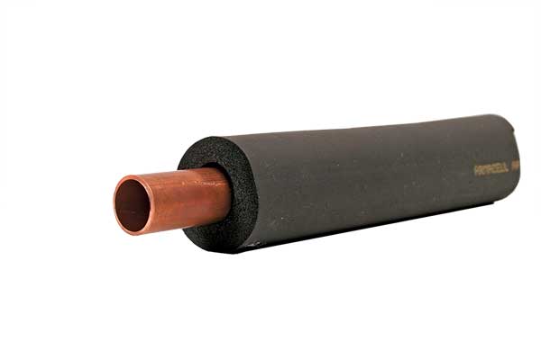

STEP 7: INSULATING MECHANICAL PIPES
Code: N1103.3 Mechanical-system piping capable
of carrying fluids above 105°F (41°C) or below 55°F (13°C) must be insulated to a minimum of R-3.
What it means to you: Although this might clear up an inconsistency between previously stated requirements of 1-in. insulation (which is approximately R-4), it at least raises the required insulation values from R-2 to R-3 as a compromise. Remember, though, that this code focuses on mechanical pipes, which could carry fluids such as glycol, not potable-water pipes.
