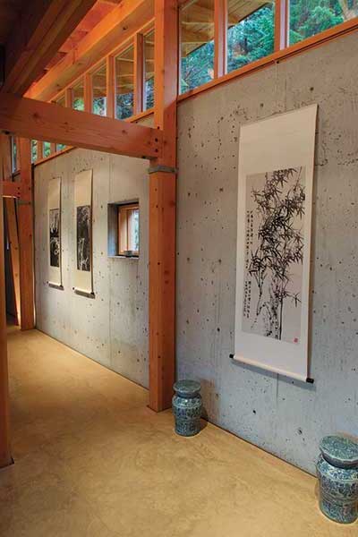

Thermal mass walls are often used in conjunction with passive solar design strategies to gather heat in the day and release it in the evening.
Image Credit: Rob Yagid, Fine Homebuilding 204
