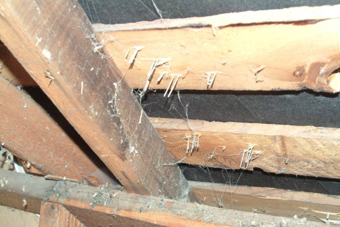

Jan Verschuren has a nicely roofed older house, and a problem to go with it. Cedar shingles have been installed over skip sheathing, making for a roof that’s not only historically correct but one that allows air to circulate freely beneath the roof deck. Verschuren’s next objective is to insulate between the 2×4 rafters, and here’s where he has run into a snag.
Building codes require at least R-38 worth of insulation in the roof. Ordinarily, that wouldn’t be a problem, but Verschuren says that he has only the 3 1/2-inch deep rafter bay to work with. He can’t afford to lose any headroom by adding insulation below the rafters, and he’d rather not tear off the roof to add extra insulation on top of the rafters.
He’s zeroed in on a type of insulation called Spaceloft with a reported insulating value of R-10 per inch. The distributor’s web site describes Spaceloft as “a flexible aerogel composite blanket.”
“So, 3 1/2 iches is all we have, but we’d like to get to an R-50 or thereabouts in our upgrade of this 1925 house built in Climate Zone 4C,” he writes in a Q&A post at GreenBuildingAdvisor. “Spaceloft seems the only option.”
Verschuren thinks he can get nine layers of this material in the rafter bays, followed by one or two layers over the bottoms of the rafters.
There are a few downsides, however: The cost is “exorbitant,” and Verschuren still has to figure out how to detail the installation so it will be vapor-open and able to dry out.

The problem we are having is depth. We are going over top of the rafters with the Proloft to get the benefit of thermal breaks. That way we are now leaning to get to R48. (Contractor here mentioned 48 being the new code here) That means 4 layers now instead of two overtop of the rafters. The price is never ever going to be justified as in: return on investment. Our goal is to get the total chain of items to work as best in unison as possible. Radiant heating works most efficiently the more you can drop your water temp. In this old house that means meeting code is nothing wild. So that is what we want to do and that we spend that money is our decision. I am not saying everybody should do this. But when we now say: you are allowed to build below code as it is an historic, grand fathered in home, that is only that. We do not want to do that. It guaranteed will never pay itself back. THAT is not the question.
The goal is to create an as comfortable home as possible, and with radiant you can do that ONLY when your insulation is in place.
Let's say some people buy a Rolls Royce. WHY? Pointless in my opinion. But not to that person.
You mentioned cooling being ridiculous for the NorthWest in another posting. With this heat wave we are having now we definitely disagree. Good sleep is crucial for healthy living. And summer has not even begun...
Now, I copy my installation question from the other posting here. See if you are worth sending you that P85D one day.... :-)!
Installation advice.
Full WarmBoardR on the inside, so no venting to be had there. Our cedar roof installed as skip sheating is TOO vented. So best way to (no foam) seal this as airtight as can be: Tyvek for protectection around the rafters followed by MemBrain. Tyvek to protect the MemBrain.
OUTward venting in climate 4C. Replacement of cedar roof (in 30 yrs we hope) will probably get plywood sheathing overtop of the skip sheathing, and will then hamper the ventilation to a degree. With 0.5" plywood and limited length staples it makes installation safer: to not penetrate the Tyvek and Membrain down the road.
Jesse was helpful to advice the use of PL200 or PL400 construction adhesive to hold the Proloft in place during installation. I would need some help probably to temporary hold things in place, like a construction glue. Same for the Tyvek and Membrain. Stapling the Tyvek(?) but spot glueing the MemBrain?

Skip sheathing under #30 felt & cedar shingles though air leaky, is not anywhere near "vented" from a code definition point of view, and can't be treated as such. You would still need 1" of air between the skip sheathing and the cavity insulation to meet code, which means you're down to about 2.5" of space for insulation between the existing rafters. Given that it's skip sheathing you can get away with 3" rock wool (sound deadening rock wool batts like 3" Roxul Safe'n'Sound), which has an R-value of about R12-R13). With a 15% framing fraction that comes out to about R10 whole-assembly, including the R value of the WarmBoard, cedar shingles, and gypsum. If instead you installed 3" of R10/inch aerogel that would only come in at about R15, despite the R31-R32 center-cavity R. That's a VERY expensive R5.
If you install 1" of aerogel over the entire interior between the rafters and the WarmBoard with 3" rock wool in the cavities you'd be at about R20 whole-assembly, using 60% less aerogel.
To fully hit the U0.026 code max would take 3" of continuous aerogel between the WarmBoard and the rafters as well as the 3" of rock wool in the cavities between the rafters. Center-cavity R would still be less than the R49 code-min, but thermally breaking rafters with R30-ish aerogel gets you there by lowering the U-factor of the assembly to under the U0.026 code-max.
With a properly (or almost-properly) vented roof assembly you don't need the MemBrain, just make the ceiling gypsum air-tight. With the high density of rock wool batts wind-washing on the vented side is very minimal- even without exterior side air barriers it still performs. But it doesn't hurt to have Tyvek as an exterior air barrier, as long as you have at least 1/2" to the skip-sheathing (and more than 1" to the #30 felt between the skip sheathing planks.)

"To fully hit the U0.026 code max would take 3" of continuous aerogel between the WarmBoard and the rafters as well as the 3" of rock wool in the cavities between the rafters. Center-cavity R would still be less than the R49 code-min, but thermally breaking rafters with R30-ish aerogel gets you there by lowering the U-factor of the assembly to under the U0.026 code-max."
3" below the rafters is just not there to be had. 4 layers of Proloft 4 cm, 1.5" would give us R16 below the rafters. With 9 layers between the rafters, R36 would get to a layman's R52. You tell me what I would loose and end up with realistically it being between the rafters mostly.
The Proloft would have similar characteristics like Rockwool I would think, being very permeable.
I am hoping to retrofit these metal plates(pic below) in between the cedar shakes making the cedar roof absolutely open to air movement. Code or no code: with these plates (a canadian invention) my roof assembly will be vented. HENCE my worries that Tyvek alone will not give me enough air tightness to make my Proloft perform as advertised. So that is where I was thinking of adding MemBrain, but to the outside. To the Inside will be air and vapor tight with the aluminum WarmBoard R.
And regarding Rockwool. I am a bit surprised you recommend to go with the Safe'N Sound batts. They are unrated for a reason I would think. They will definitely carry an R value, but what we do not know...

You can't put 9cm of insulation underneath the skip sheathing and still call it a vented roof, no matter WHAT you do with the shingles above. The shingle spacers vent the shingles to keep them from rotting, but the #30 felt layer above the skip sheathing has too low a vapor permeance to count on the skip sheathing to be able to dry to the exterior. You can probably get away with 8cm, but to meet the letter of code on vented roofs you'd need 2.5cm between the skip sheathing & insulation.
Tyvek that is tight to the Proloft (or rock wool) is a sufficient air barrier for thermal performance purposes- don't sweat that one.
Assuming you could get away with R36 in the cavities and R16 under the rafters behind the WarmBoard, if we assume the WarmBoard + gypsum adds up to R0.8 and the skip sheathing + shingles, with a 15% framing fraction you end up at about R34.5 whole-assembly, or U0.029, with a 12% framing fraction (not likely, but maybe) it's about R36.5 whole assembly or U0.27, still not quite the U0.026 code-max.
If you back off to only 8cm / R32 to provide better roof venting that becomes about R32 whole-assembly /U0.031 or R34 whole-assembly/ U0.029 for 15% & 12% framing fractions, respectively.
If you did the cavity fill with R4/inch rock wool (R12 @ 3") and added R16 aerogel on the interior that comes in at about R27 / U0.037 or R28 / U0.036 respectively.

Venting impossible
Dana, Martin,
A venting channel is only partially possible. See the pics attached. Venting from the gables is not possible either due to the only 4" deep rafters.
With all these constraints it is now getting into an Apollo 13 mission... I never thought the venting would be a problem on a cedar roof. But reading this 457 newsletter: http://foursevenfive.com/unvented-foam-free-roof-retrofit-with-dolphin-insulation/ it states all can be done, EXCEPT on a vapor drive susceptible cedar shake roof...

With the skylights and the perpendicular front door overhang and walk in closet: venting is impossible to properly do.

There is no route for any air go anywhere with this roof. Even if I would built inward or outward, which I cannot do.

The MemBrain is necessary as
The MemBrain is necessary as a drying path for the unvented assembly, since without it there is none. No matter how dry you keep the interior the skip sheathing and rafters can't dry toward the interior if it's covered with WarmBoard, and without vented sheathing it can't dry toward the exterior. You may be able to just use air-tight drywall & latex if you keep the interior moisture levels low, but it's riskier. With MemBrain any moisture that gets into the rafter bays (from any source) that reaches levels high enough to be a problem leaves about as quickly as it would with just air tight drywall & latex paint. But when the rafter bays & sheathing are relatively dry moisture migrates into the rafter bays from the interior space at 1/10th the speed as it would through air-tight drywall & latex.
The average mid-winter temperature of the skip sheathing is about 40F, so as long as the average interior air has a dew point lower than 40F there isn't much moisture drive. But that is about 30% relative humidity at 70F, which is the very low end of what health professionals recommend. Most homes in the northwest would have air that's 40-45% relative humidity in winter, which has a dew point of 44-48F. While the moisture drive from the is low, the direction is from the indoors out to sheathing, and there is no reliable drying path for the sheathing.

Membrain it is. Thinking it all through: what about this to hold the MemBrain in place over the rafters, to keep it air tight. Strip of acoustic caulk. And this over top: http://www.supplyhouse.com/Oatey-33927-3-4-100-Plastic-Hanger-Strap-Bagged
The tack staples for the continuous thermal break insulation can punch right through. As can the WarmBoard screw. Drywall screws go into the WarmBoard.
And regarding the application of acoustic caulk: FORGET a hand applicator when you have to use it a bit... First cartridge killed my hand from the start. Get a pneumatic applicator! NOW it's WAY better and easier to apply! Super control and steady hand. Use half the caulk and EXACTLY where you want it to go.
Yes Martin, the Felt was rolled out over top of the skip sheathing. The shakes were than installed overtop of the felt. Don't ask me why. The roof was leaking, it was a phone call and go!
Looked up the Cedar Breather, interesting product. What we installed on a new out building were these metal plates(pic attached) that create a space between the shakes. Plus creates a metal roof, vented, underneath the shakes. I like that stuff. Will have to see the Cedar Breather but these metal roof plates are a pretty smart invention as well. As with the Cedar Breather probably, best is to install with the new roof install. The metal plates can be installed afterwards but will need screws. And those do not fully penetrate, but I am trying to negate that for the existing roof. Any thoughts on that? They just need to be held in place and sustain the swelling and shrinking of the roof. I'll take some pics of a retrofit of these plates on a house in Canada. It may be the only way to do it but it's not great...
Insulation of the metal roof will be Spider. For the shakes Proloft.
Just spent the half day emailing with Johns Mansville and the local rep to look for an installer. None to be had. Only Spider blown in behind bibs. UNTIL I "ran into" a local installer who DOES install Spider with the acrylic binder, without any netting needed. Even for a ceiling install. Nice!
BUT Johns Mansville now has the Spider Plus, no acrylic anymore but water....
Tomorrow I'll hear what the full difference there is but so far it looks like the local Spider installer can only do the old fashioned acrylic install. Which is a relief that he CAN do that.
