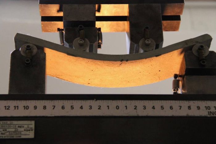

Unlike conventional concrete, engineered cementitious composite (ECC) can bend under pressure without rupturing. (Photo: Victor Li)

We call the resulting ductile concrete engineered cementitious composite (ECC) or strain-hardening cementitious composite. It can deform up to 3% to 5% in tension before it fails, which gives it 300 to 500 times more tensile strain capacity than normal concrete. This allows a slab of it to undergo a lot of bending without fracturing into pieces, earning it the nickname of flexible or bendable concrete.
