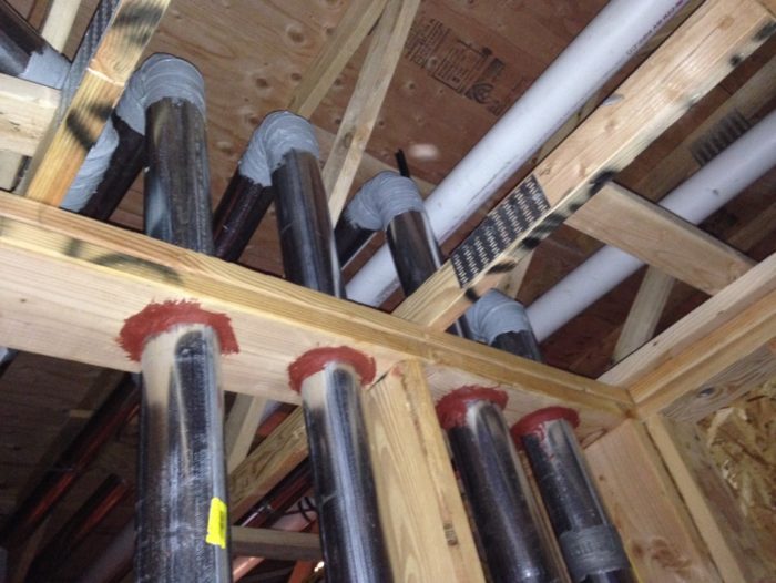

These 4-inch round ventilation ducts are routed through a 2x8 framed wall between the bathroom and bedroom. The top plate penetrations are carefully air-sealed.

Distribution of the ventilation air from the ERVs is via 4-inch hard ducts running directly to and from each apartment. These duct “home runs” are collected into main trunk lines running above the ceiling at the third floor corridor (see Image #5, below). By keeping the duct penetrations no larger than 4 inches in diameter, this approach eliminates the need for fire-smoke dampers at each apartment (see Image #6, below).
A continuous 50 cfm of supply air is delivered to each bedroom, with continuous exhaust from each bathroom and kitchen area. To filter cooking pollutants, recirculating hoods are provided above the kitchen ranges. Continuous air flow regulators installed within the ducts help to ensure balanced continuous airflow into and out of each apartment.
