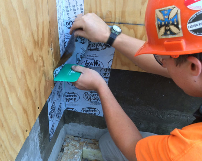

Every hole must be sealed. Transitions in the plane of airtightness need particular attention, especially when those transitions occur at corners. Here Doug is detailing a wall-to-foundation transition at an inside corner. He is using a tool to help work the peel-and-stick into the fold and ensure adhesion to the primed substrate. Some wet sealant will be applied to the membrane at the pinhole corners to minimize air leakage.
