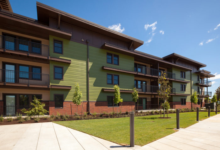

The Orchards at Orenco project has two types of cladding: brick veneer and fiber-cement. Balconies and “eyebrow” elements are designed to shade the windows and doors to mitigate overheating in the summer months while still allowing solar gain during the winter months.
Image Credit: Image #1: Casey Braunger

The building is clad in fiber-cement siding and brick veneer (see Image #12).

Supporting the brick veneer
Brick veneer generally only occurs at the base of the walls, extending four feet or so up the facade. In typical construction, brick veneer is supported on a ledge that is cast into the foundation; however, this approach creates a large thermal bridge. To minimize thermal bridging at this project, the brick veneer is supported on a continuous 4”x4” galvanized steel ledger angle that has been thermally isolated from the primary structure, using off-the-shelf steel FAST brackets (manufactured by Fero Corporation), installed at 3’-0” on center along the concrete foundation around the base of the building (see Image #18).
By using these brackets, we were able to apply the expanded polystyrene insulation in a continuous layer over the exterior side of the concrete foundation (see Image #19). After the steel brick ledge was attached (see Image #20), the brickwork began (see Image #21).
