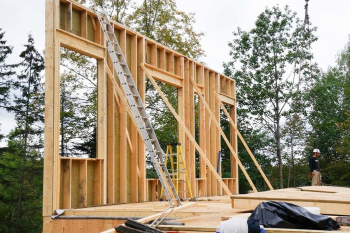

The double-stud wall design consists of a 2x8 structural wall and an interior 2x4 service wall. Both are insulated with mineral wool batts.

For the above-grade walls, we ended up using a double-stud wall assembly. The structure of the house is built with 2×8 lumber, which allowed both for necessary support on the tall wall in the upstairs, as well as providing a deep space for insulation. The bays in this wall were filled with Roxul batt insulation, a mineral wool product. Mineral wool is a quite well regarded insulation, as it is very pest, water, and fire resistant, is easy to install, and holds its shape well, all leading to good long service.
On the inside of this 2×8 wall is the polyethylene air/vapor barrier. Inside of that is a 2×4 utility wall, holding all of the electrical, plumbing, and data cabling. This wall is also insulated with Roxul insulation. Finally, a standard layer of sheetrock provides the interior walls.
A big advantage of the utility wall is that all of the openings that need to be cut, for outlets, fixtures, etc., don’t need to punch holes in the air barrier, keeping the air tightness higher. Outside of the 2×8 wall, there is a layer of plywood, then 1 1/2 inches of Roxul ComfortBoard, which is very similar to the batt insulation we used, but a firmer and coming in sheets.
Wrapping all the walls in mineral wool limits thermal bridging, where heat would pass through the wood framing (which is a poor insulator compared to the insulation it holds in place).
Finally, the exterior has 1×3 wooden strapping to allow for air circulation and water drainage, on which Hardie fiber cement board is mounted. Altogether these walls are a nominal R-47.
