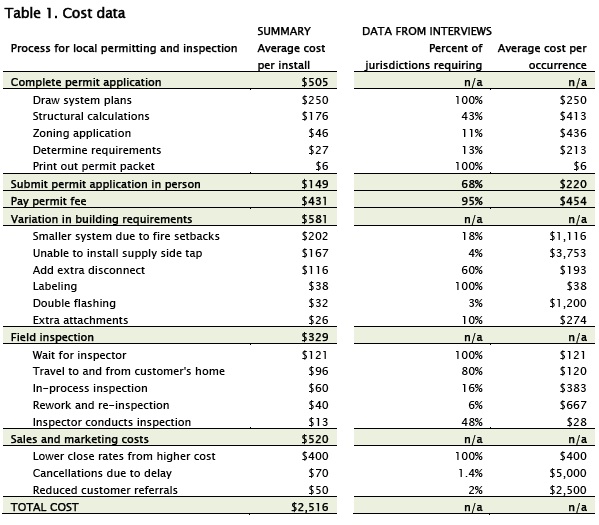

This table, produced by solar installer SunRun, summarizes the cost of local inconsistencies in the permitting and inspection processes for the installation of photovoltaic systems – about $2,516 per installation and $0.50 per watt.

As some of the anecdotes and observations in a recent New York Times story illustrate, many companies that specialize in the installation of photovoltaic systems have departments dedicated entirely to securing permits – an arrangement that, while necessary in many regions, is as costly as it is frustrating for the companies and their customers. One company cited in the Times article, San Francisco-based SunRun, released a report this week indicating that permitting and inspections cost an average of $2,516 for each installation and, over the next five years, will add about $1 billion to installation costs nationwide unless the process is standardized to a substantial degree.
