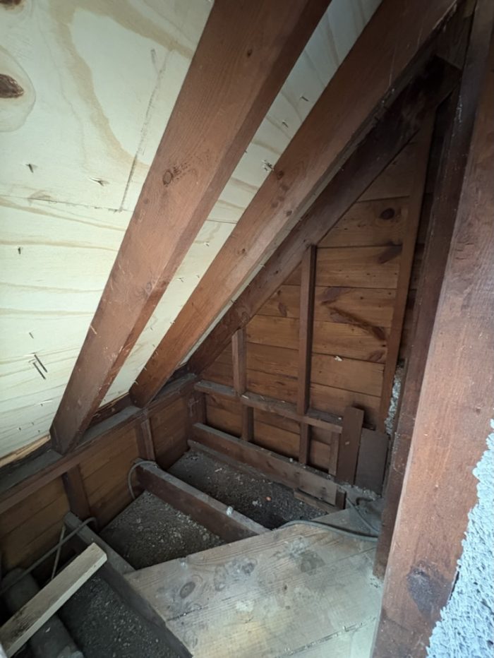

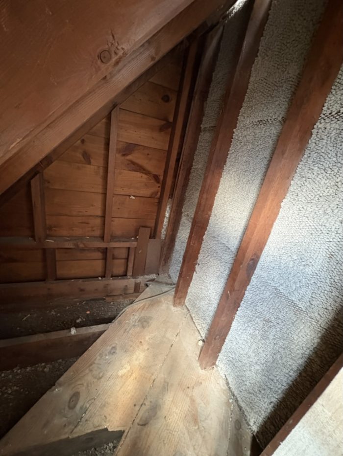

  16. user-974013 | | #16
    Ok, this is one of my favorite fixes
    If done right you become a legend to your customers!! I totally agree with taking the insulation to the roof slope when budget or materials permit it.
    The only way to deal with a knee wall (if you have the means) is to spray foam the deck, it takes a little more than a typical spray job though...
    You have to consider the ceiling slant, is there old cedar shake nailers left over? If so, you cannot spray the foam on an angle up and down to cover the deck (you will be back to rip out the rock/plaster on your own dime due to condensation). Is the slant providing air flow across the roof deck into the devil's peak attic? If so you must baffle the knee wall roof slope and the ceiling slope as well to to continue the air flow....
    The best way I found to do this properly (if BUDGET permits) is to rip out the rock from the ceiling slant and ceiling flat and foam the entire roof deck of this room. If a bonus room you can simply dense pack the garage ceiling that is exposing the room to the garage (draft block the area going into the living space, there is no reason to flood the entire cavity).
    If you cannot or prefer not to do the roof slope, spray foam the entire wall, it will be seamless, and will prevent thermal bridging. The floor cavity under the wall is easy, use Owens Corning 3/8 fanfold foamular, this is a quick and easy way to draft block. The 3/8 inch sheet is easy to cut, you can measure it on the floor joist and spring fit...once you foam it... it is air tight and at the proposed R-Value....
    I am digging up some photos for example (of real jobs, that have got nothing but praise and withstood the test of time)...
    I cannot upload knee wall spray foam photos at this time....the files are to large!!!

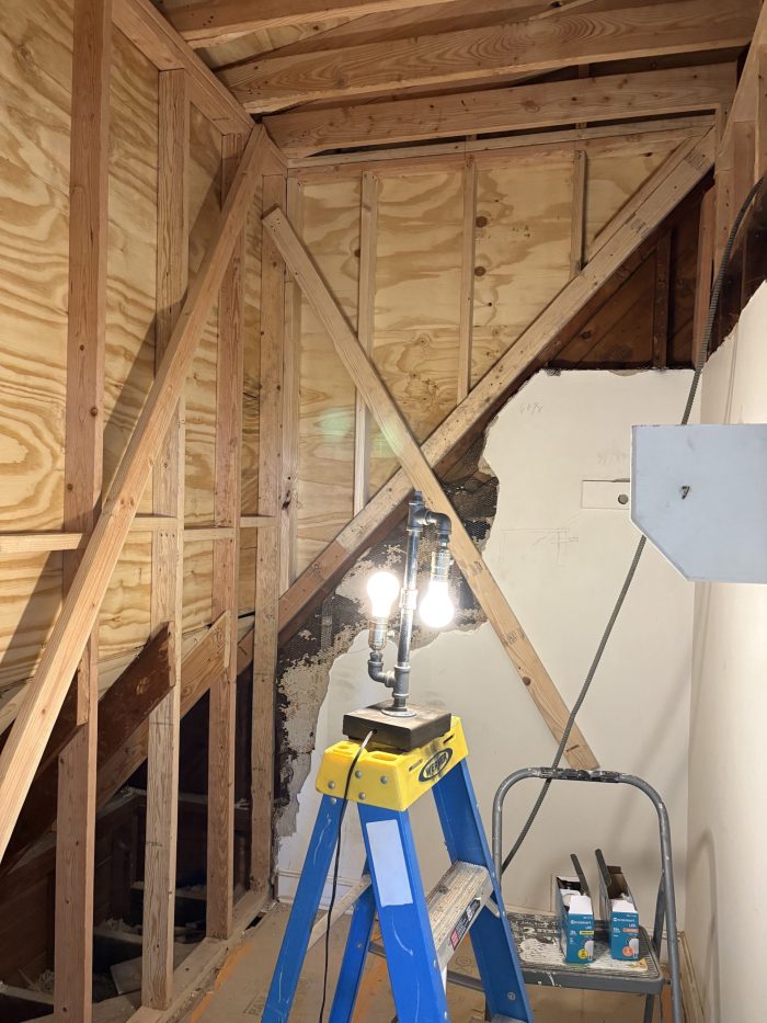

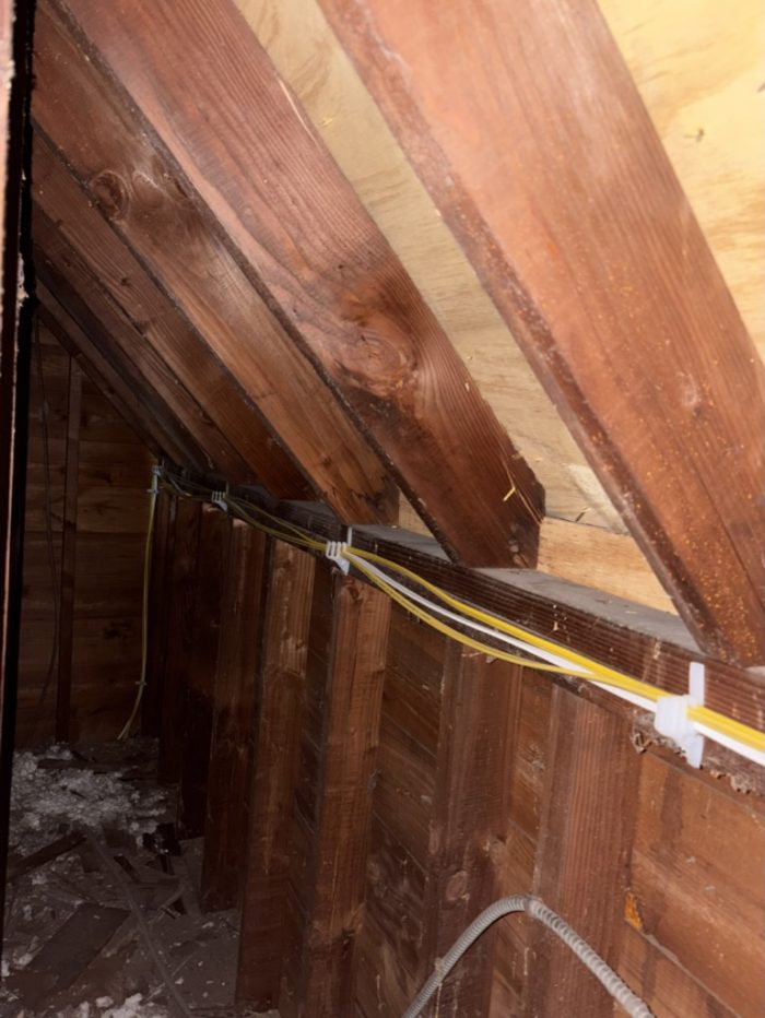

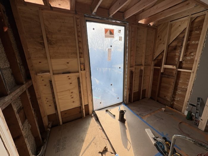

  17. user-974013 | | #17
    Trying some more photos
    See below....
