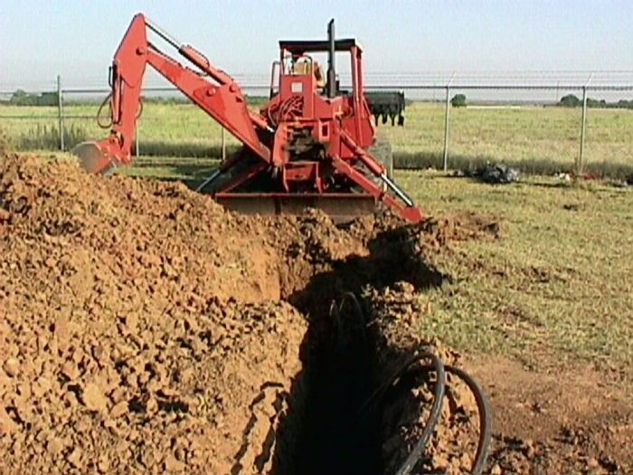

The extensive excavation that ground-source heat pumps often require is one sticking point for some homeowners, and so is the cost. Many estimates from experts for a complete system top $40,000, with one as high as $50,000. (See Are Affordable Ground-Source Heat Pumps On the Horizon?). That’s far above the cost of competing technologies.

    The discussion in the podcast seems to exaggerate the scale of the drilling rigs being used in typical practice: I don't think huge oil/gas drilling rigs that require a big crew to operate are common. I'm sure that happens, particularly in oil/gas regions at times when there are rigs sitting idle, but around here it's done with water-well drilling rigs, which fit on a modest size truck and are operated by one person. They typically drill 4" holes, and the rigs typically max out somewhere between 300' and 600' of depth. Nonetheless, there are real savings possible there. It's not a new idea to have a rig that is specifically intended for GCHP wells, or to use a smaller rig, but I think that opportunity is underutilized. For a GCHP, you don't need 600' depth even if the design says you need that much: you can use 6 wells each 100' deep. And with them plumbed in parallel, you can reduce the pumping power to circulate water in them vs. one 600' deep well.
    With numerous wells to connect, there could be a need for a lot of trenching, which adds cost and makes a mess. Directional boring can avoid that by making multiple wells go off in different directions from one well head. And you can bore a longer well for a given depth going at a diagonal or even going horizontally at 20' depth. My understanding is the size of the rig required scales up rapidly with more depth, but not so much with horizontal length. And by avoiding going deep you can sometimes avoid boring through rock. Rock can be good for thermal performance, but without enough soil involved you don't need rock. I don't know whether this company is using directional boring, but that seems like a really good opportunity for a company like them.

    Would be interesting to know how the economics compare to horizontal loops, perhaps with equipment specifically designed to trench efficiently.
