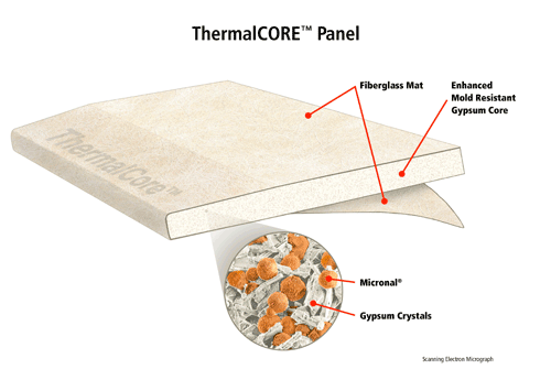

National Gypsum’s ThermalCORE that was introduced at Greenbuild (but is not yet on the market) is a micro-encapsulated paraffin PCM. Tiny spheres of paraffin, just 5-10 microns in diameter (less than half the size of Portland cement particles), are encapsulated in acrylic shells, and these are mixed with the gypsum in drywall. The paraffin melts at 73°F, plus-or-minus 2°F. The PCM used in ThermalCORE is Micronal, made by the German chemical giant BASF. Micronal was introduced about five years ago, and BASF has been looking for a U.S. drywall manufacturer to partner with on a PCM wallboard.
BASF’s Micronal PCM is available in commercial products in Europe, and it has gone through extensive testing. According to a BASF scientist I spoke with at Greenbuild, the material has been tested through 10,000 phase-change cycles (equivalent to 30 years of use) with no loss in performance.
National Gypsum’s ThermalCORE has fiberglass skins (instead of paper), but otherwise looks no different than standard drywall; the micro-encapsulated PCM spheres are far too small to see.
Studies show that the ThermalCORE wallboard stores about 22 BTUs of thermal energy per square foot. The idea is that warmth from the sun during the day will be stored in the wallboard, and then released at night to keep the space warm. It will both help prevent overheating during the day and help reduce heating costs during the evening hours. In essence, it’s a high-tech form of thermal-mass materials that are typically used in passive solar design (brick facing walls, tile floors, etc.).
