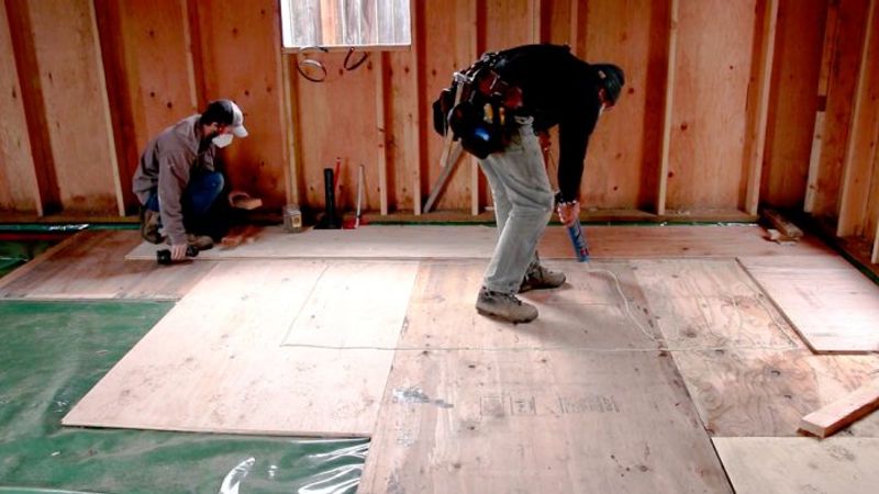

In this video, Josh Salinger, owner of Birdsmouth Design-Build, is on-site in Portland, Ore., to show us how to create a more eco-friendly slab assembly by laying two layers of graphite polystyrene (GPS) foam insulation on top of compacted stone, covering that with a polyethylene vapor barrier, and finally topping it all off with two floating layers of tongue-and-groove (T&G) plywood.

      The plywood is floating. It is not connected to the perimeter walls where the footings are. It is my assumption that any movement be it seasonal, drying of initial construction moisture, live loads, etc. will expand/contract and shift as needed. There is a roughly 1" gap between the stem walls and the floating floor to account for this. As with most things, I didn't come up with this idea myself; rather I first heard about it in a 2005 article by Andy Engel called 'The No-Mold Finished Basement' (FHB 169) and it was elaborated upon by Steve Demetrick in the November 2006 article in JLC titled 'A Basement Floor Without Concrete'. In the latter case, Steve talked about this in a B.S. and Beer show and tells about how he was able to visit this project and see that there was no movement, damage or otherwise roughly 15 years later. At any rate, it is a new idea and it is good to think all of these things through.

    One question: is 1-3/8 really short enough? It seems like if you accidentally bury the head a bit, combined with tolerances in the plywood, that's actually nominally 23/32 rather than 3/4, you could end up with a puncture.
    Minor note: I'm pretty sure I saw a sticker that said the polyethylene is 10 mil, not the 6 mil stated in the narration. (For anyone outside the US trying to make sense of that, 10 mil is about 0.25 mm.)
    1. Trevor_Lambert | | #14
      I was thinking the same thing. I definitely would have gone with 1.25" screws, even if the plywood is a full 3/4. 1/8" margin for overdriving a screw is too close for comfort. If it was shy 1/32, then that leaves only 1/16 margin of error.
      I didn't notice the marking in the PE, but it didn't seem to behave like I'd expect 6mil to behave, seemed at least as rigid as the Super8 stuff I've handled in the past.
      Joshua Salinger | | #22
      Charlie,
      Good eye. I mistakenly said '6 mil' on the video when in fact the vapor barrier is indeed 10 mil. I was coming up with this extemporaneously in front of the camera... I notice all these errors all the time when I see myself recorded. Hopefully the larger content supersedes the mistakes!
      In regards to the screw sizing, I'm not going to die on this hill. I suppose it is a balance between getting enough grip with the screws vs. the risk of puncturing. We tested the plywood we used with some scraps and various screw types and we didn't see any of the 1 3/8" screws come through. Of course if one really buried the head that would matter and I also suppose that over the course of the entire floor this may have happened. If one feels better with a 1 1/4" screw, then by all means go for it!

    It's interesting that with a new construction slab, the order is: gravel, insulation, poly, concrete. With this alternative, it is similarly: gravel, insulation, poly, (wood) floor.
    But the retrofit version of this (floating a floor over an existing concrete slab) often cites: concrete, poly, insulation, (wood) floor. It makes me think perhaps the poly should go above the insulation in this situation as well. Or maybe it truly just doesn't matter...
      MALCOLM TAYLOR | | #8
      Tyler,
      The reason cited for placing the poly over the insulation in new slab construction is to prevent bleed water pooling below the foam where it can take a long time to dry. I've never been particularly comfortable leaving the insulation exposed to sub-grade moisture, partly because I've seen how much water the foam in hot tub lids can take on over time. If the slab bleed water is removed from the equation I'd vote for placing the poly under the foam, although as you say, maybe it just doesn't matter.
      1. maine_tyler | | #9
        Good points.
        I'd be interested to hear the reasoning from those that have done this type of assembly for the order they chose. It's not consistent, which is perhaps anecdotal evidence that it's not an issue either way. One such assembly — https://www.finehomebuilding.com/project-guides/insulation/a-concrete-free-slab-on-grade-foundation — places the poly between layers of foam.
        Perhaps the reasoning revolves more around sequencing, materials workability/protection, or is a flip of a coin.
        The only possible issue I can cook up with the foam over the poly is vapor condensing on the colder poly. I don't have any reason to think this IS an issue, only that it seems remotely plausible. Perhaps a complete non-issue.

      Joshua Salinger | | #23
      Tyler,
      Good observation. The layers are exactly the same. The reason being is that there are 5 layers to any successful slab on grade: 1. Stable soils/substrate; 2. Capillary break and soil gas depressurization field (usually 3/4 gravel with no fines); 3. Insulation layer; 4. Vapor control layer (a Class 1 vapor barrier); 5. The finished slab (be it concrete, wood or otherwise) that people and items stand on.
      For retrofits, one is better served by skipping the poly and instead going with a liquid applied vapor barrier such as an epoxy coating. Small air gaps between the poly and the concrete will eventually equal out to 100% RH and this can cause mold or if there are minor holes, evaporation which can transport moisture and damage flooring. The insulation goes over the liquid applied coating (usually 2 coats). Then float the floor. Dr Joe Lstiburek has a great article on exactly this at Building Science Corporation. So does his Daughter Christine Williamson at her IG account, Building Science Fight Club. They are much more articulate about this than I am and I encourage anyone to check these resources out.
      Another reason why the insulation should go below the poly (besides the really good points Michael brings up with the floating of the insulation and Malcom's point about the bleed water) is that foam insulation will get saturated if exposed to liquid phase water. Damp insulation begets critters and they will damage the insulation over time. Better to keep it dry.
