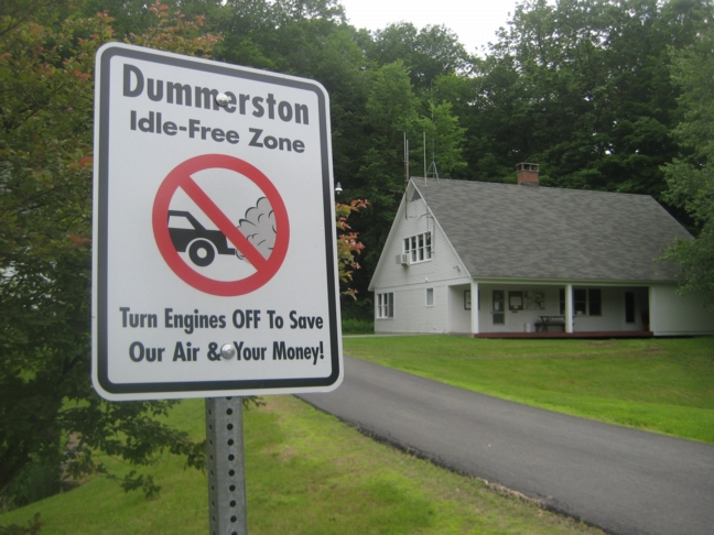

Idling cars waste gas. A “no idling” sign in my home town reminds residents not to idle their cars.
Image Credit: Stan Howe

Avoid idling
If the engine is running and you’re standing still, your fuel economy is zero — and an idling engine usually spews out more pollution than an engine that’s running at higher speeds. Several towns in our area, including Putney, Dummerston, and Brattleboro, now have no-idling resolutions in an effort to discourage the practice. With some vehicles, such as police cruisers and diesel equipment, there may have compelling reasons to keep the engines running, but for cars and light trucks, tuning them off usually makes sense.
