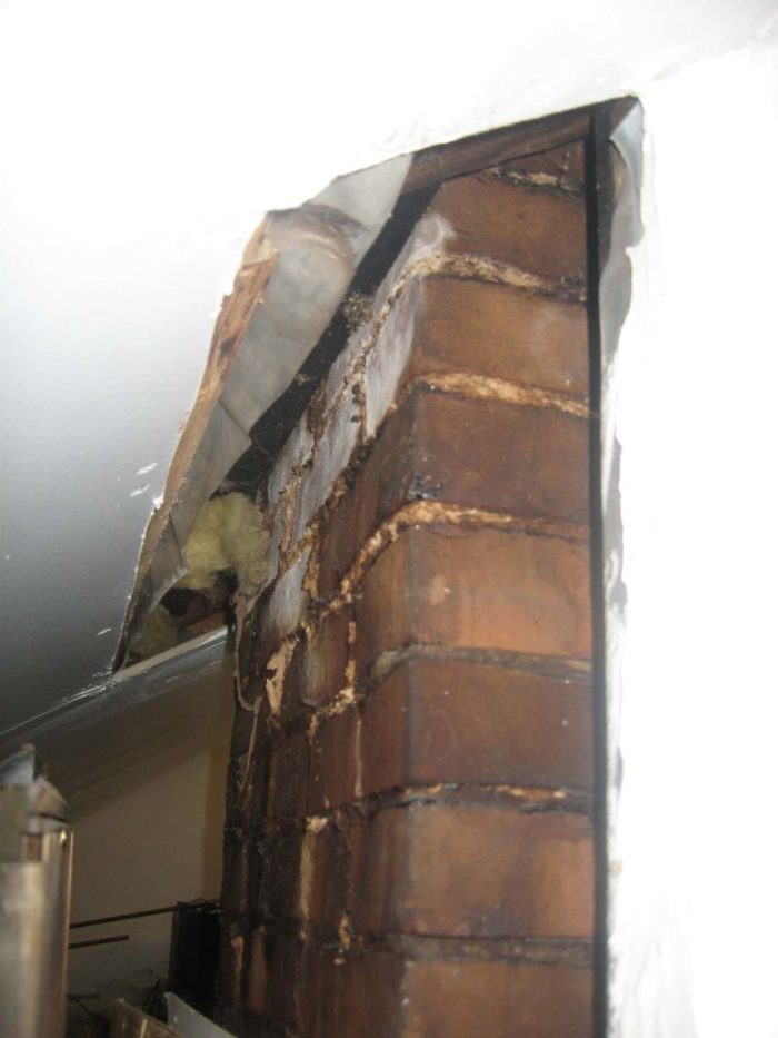

Chimney chases are a top area of air leakage in many existing homes. This chimney, going through an insulated roof, has drywall and insulation close to, but not touching it. The large gap allow plenty of room for hot air to come off the roof and into the room in the summer, and for heated air to get pulled out of the house and sent into the rafters in the winter.

1) The chimney chase. From the basement all the way up through the roof, the chimney chase is a perfect venue for the “stack effect,” in which warm, buoyant air floats up and out of the house, with cold outside air being pulled in at the bottom to replace it.
An unfilled gap between a brick chimney and the wood framing is common in old houses, creating a jet engine of air leakage. Seal it wherever you can access it—in the basement and attic, at least—using fire-safe materials. Many old homes have unused chimneys. Check that the cleanout door and any other chimney openings are properly sealed.
