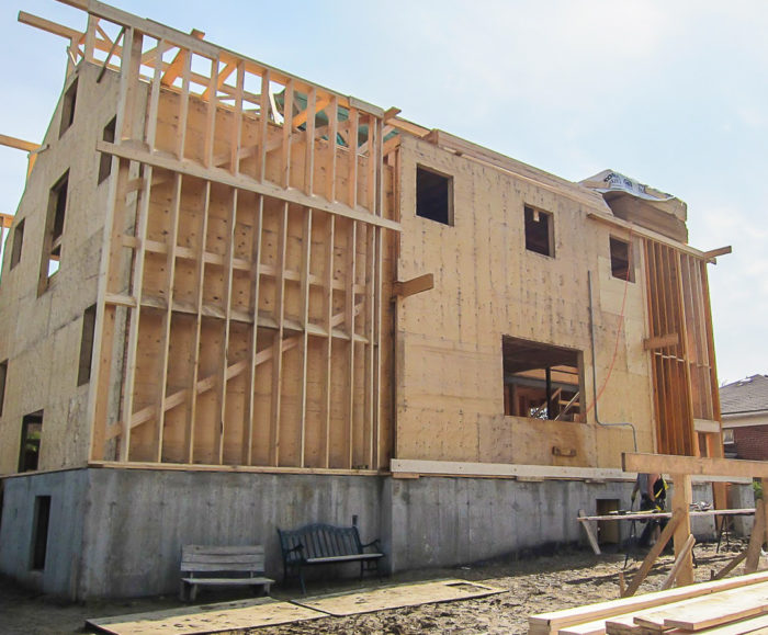

Our double-stud walls include a structural 2×6 wall on the inside, sheathed on the outside with 12 mm (about 1/2-inch) plywood, then an air gap, and finally a 2×8 wall sheathed with solid lumber. When complete, the walls will be about 2 feet thick and have an R-value of roughly 80.
Once the structural walls were up, we could build the 2×8 frames for the outside and tilt them into place. The 2×8 framing is on 16-inch centers with two rows of blocking and diagonal strapping on the backside (inside). The balloon-frame assembly does not need to meet the tall-wall specs in the code because they don’t hold up the building, but they will be braced to the second-floor assembly at mid-point just the same.
Tilting the 2×8 assembly up into place wasn’t too difficult . We used a chainfall/lever hoist anchored to a large beam in the cathedral ceiling assembly. We also used a rope hoist on the larger assembly. When we didn’t have a large beam to use as an anchor, we used cast-in 1/2-inch anchor bolts in the concrete wall on the far side of the building.
We used two rows of blocking on the 2×8 walls (visible in the photo at the top of the column). In the photo above, you also can see the temporary frame we set up on the ground for building the walls. The frame in the photo is the longest wall we built and lifted in one piece: approximately 2,000 pounds and 20 feet tall. We needed two hoists, but it worked fine.
