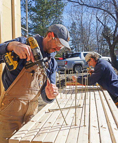

On top of the insulation and sheathing we are fitting a Pro-Clima Solitex Plus membrane, which is high-performance and expensive and was luckily bought back when we still had some money. On top of this are going double-width battens, which are secured right through the entire assembly into the cross-laminated timber (CLT) roof structure with very long (and difficult to source) screws. The battens are double-width because eventually they will have to take screws for solar panels too. The metal roof will be installed by Prestige Roofing of Kingston. We can’t afford anything fancy, and luckily we didn’t want anything other than basic galvanized steel, anyway.

We did run into a few minor problems when the crew turned to the north side of the house and the roof. The Schneider-Holz 110 base layer wood-fiber insulation remains messy to cut to size, and we didn’t have enough of the long fasteners we’ve been using to screw the battens and top layer of insulation into the CLT.
However, we managed to source another load more from the marvelous Canadian Log Home Supply, and apparently they are already on their way. That’s what I call service!

Roof screws
I'm interested in the layout/design for how your battens were screwed down to the roof. What length screw was required? Was the screw spacing specifically engineered or did the manufacturer have a recommendation?
Also the article mentioned the screws were hard to source - was that due to the length? There are a number of manufacturers which make long screws, though perhaps not if your length was really extraordinary. What manufacturer / product did you use?

Sorry, I've been busy at work and haven't replied to the comments recently. There seem to be some misunderstandings or rather negative assumptions here. The porch blocking was not an entirely 'after the fact' solution. The structure of the porch would always have been this way. As a result of some miscommunication in the ordering process, we didn't get factory-cut CLT blocks from Merk for this purpose. The only difference is that our builders ended up making their own instead of haivng them provided. The blocks are not only supported by the bottom hanger, or multiple brackets - that would be weak. The brackets / hangers are supplementary and required by Ontario building code. The blocks are screwed into the CLT wall with multiple screws, and the ledger is screwed into the blocks. The blocks can neither come apart or pull away from the wall. Like most things about the house, the connections are all over-engineered rather than under-engineered or simply meeting requirments. As for the screws, they were (I think) 15" long, as they had to go through the battens, the 11" of insulation and bite deep into the CLT roof (but not go all the way through). The original screws came from Germany and were made to a very high specification and were correspondingly expensive; the extras we sourced from inside Ontario seemed pretty much the same but weren't quite as costly. Make of that what you will! All the screws used to go through the insulation also had plastic head covers etc. to reduce thermal transmission.All this was accounted for in the calculations carried out by Tomaz Stich. Hope this helps!
