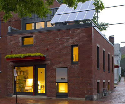

This building, which formerly had a store below and an apartment above, is now the office of Renner Architects (1st floor) and home to Richard Renner and his wife, Janet Friskey, above.
Image Credit: James R Salomon
View Gallery 22 images
It takes quite a bit of vision to imagine this unassuming retail property — located in a neighborhood that is a little bit rough — becoming a LEED Platinum rehab.

In Portland, Maine, a leading green architect walks the talk on his home and office, achieving LEED Platinum
Architect Richard Renner and his wife Janet Friskey, a graphic designer, wanted a commute in downtown Portland, Maine that involved just a flight of stairs. “We jumped at the opportunity to purchase an old clothing store with an apartment above,” says Richard.
That turned out to be the easy part. “Our goals for the first-floor office and residence loft were an efficient building envelope, plenty of daylighting to the interior, and open floor plans for both spaces. And while we were at it, make the loft a LEED for Homes Platinum gut rehab.”
