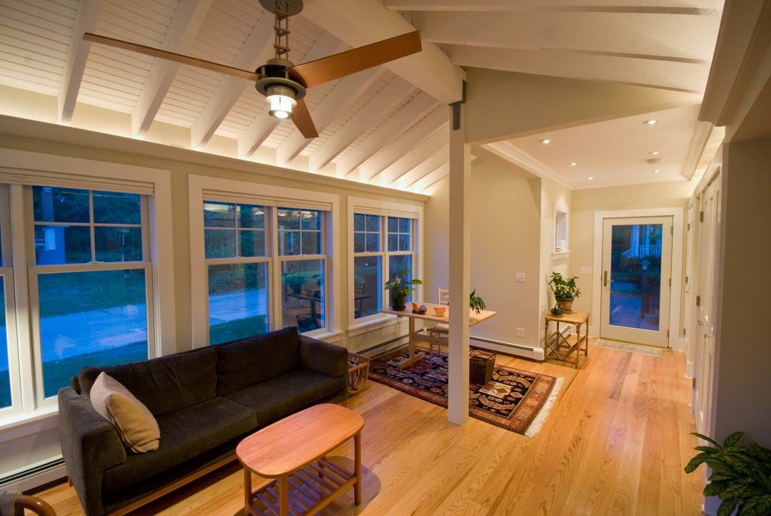

The Red Oak flooring and the exposed rafters, beams, and roof decking all came from local sawmills.

This new addition is a multipurpose space that replaced a cramped, old porch.

Rigid polyisocyanurate foam insulation is on the outside of the exposed sunroom ceiling. A vented roof assembly sits above the foam.
Image Credit: Joseph Cracco
Rigid XPS foam insulation was installed outside of the roof sheathing to allow for the exposed rafters and to create a good thermal break. Fiberglass in the walls, XPS foam in the headers, and and ICF foundation round out this tight envelope.
