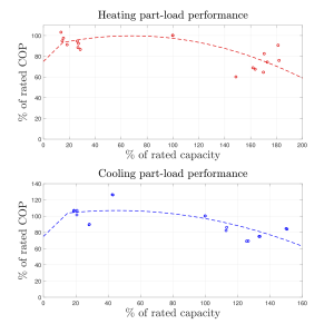

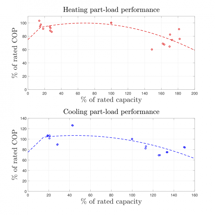

  7. kevin_kircher | | #21
    Also, to your point upthread, Jon:
    "I've seen (somewhere), data showing that 40% over-sizing of an inverter heat pump was beneficial. Clearly at some point things reverse, but nobody has any data (vs thought experiments) showing that up to 100% over-sizing (peak or rated output to design day load) of inverter heat pumps is an overall negative?"
    The clearest real-world data I've seen on this from this 2015 DOE report, "Field Performance of Inverter-Driven Heat Pumps in Cold Climates". Link:
    https://www1.eere.energy.gov/buildings/publications/pdfs/building_america/inverter-driven-heat-pumps-cold.pdf
    In Section 4.2.5, Williamson and Aldrich wrote the following.
    "Inverter-driven compressors can achieve high efficiencies because they have the ability to modulate output to match the heating load. However, when the load drops below the system’s minimum capacity, cycling can occur. Cycling is known to have detrimental effects on the efficiency of these units (Christensen et al. 2011).
    At Site 2, a highly insulated Passive House that utilized the DHP as the only heating source, the DHP began to cycle when the outdoor temperature exceeded 40°F. This trend is clear in Figure 13 in the Results section; COP actually drops at higher temperatures when more cycling occurs. This home had a design load of 6 kBtu/h and a 1-ton system was installed (Mitsubishi FE12). Figure 42 displays the power consumption during one of these periods of modest loads (in April 2014). At these conditions (ODB = 55°F, indoor dry bulb = 72°F), the system’s capacity was limited at approximately 5,000 Btu/h. These operating conditions translated to a COP of 1.41 for the day."
    I attached a copy of their Figure 13 for reference.
    For what it's worth, I think undersizing mini-splits is also bad. Manufacturer data I've seen suggests that COPs drop off at very high load, too. A tiny mini-split that spends most of its time going full blast may perform worse than a huge one that spends most of its time cycling. Somewhere in between is a sweet spot.
    1. Jon_R | | #23
      So at near zero load on one model, COP with cycling dropped to 1.41 (from the graph in fig 13, I'd say such very low load COP = 1.5). But we also know that COP with modulation can drop below 1.5 (see #10 above). If I had to form an opinion from such limited data, I'd say "modulation to low levels vs even quite short cycling shows no difference in efficiency". Quite different from popular opinion.
      Then there is the issue of looking at efficiency at single operating points - what really matters is seasonal efficiency (ie, even large efficiency differences don't matter if it's rarely operated at that point).
      But looking at that reference, I don't see any data regarding cycling.
      One would think that some researcher would install two inverter mini-splits side-by-side, one 100% over-sized, and cause them to be active on alternate days. Measure energy draw, temperature fluctuation and humidity over a year.
      I agree. Probably pretty broad/flat (eg, little difference from 0% to +100% over-sizing) for inverter units.

  11. kevin_kircher | | #29
    Thanks for the link, Jon. That's a good point about thermal mass, cycle length and dehum.
    "No idea if residential heat pumps have similar curves."
    Mitsubishi mini-splits, at least, have efficiency curves that look similar at the high end to the one you linked. See the graph I attached.
    That data is from the most recent 6, 9, 12 and 15 kBTU/h M-Series submittals and the NEEP spreadsheet. Note that the horizontal axes are percent of *rated* capacity, rather than of maximum capacity. Maximum capacities are quite a bit higher than rated. Also note that the axis limits are a bit different for heating vs. cooling.
    I haven't been able to find any data published by Mitsubishi on COP below ~20% of rated capacity (when Mitsubishi mini-splits start cycling), anywhere. The dashed lines at the low ends of those graphs are just a best guess based on (sparse) laboratory tests and field experience reported in the research literature.
