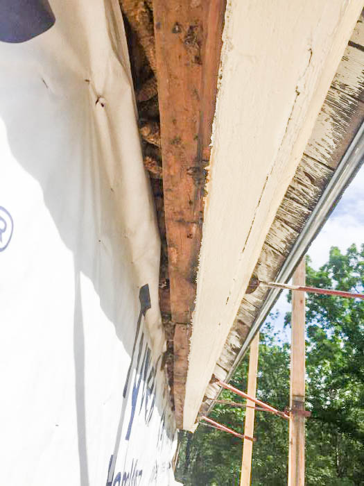

Jonathan Sinclair’s home, a 225-year-old timber frame in New Hampshire, is getting a facelift. Sinclair is residing the building with fiber-cement lap siding, and he plans to install the siding over a vented rainscreen—a thoroughly modern detail.
“My question comes from building an adequate soffit vent that will flow air,” Sinclair writes in this recent Q&A post.
As he explains, the original builder included 2×6 soffits with a 2 1/2-inch-wide gap between the building and the edge of the soffit. That gap was then covered with molding. Sinclair plans to incorporate this gap into the top of his rainscreen so that air will have a continuous path from the bottom of the house to the attic. Ridgevent 20 (manufactured by Air Vent Inc.) at the top and bottom of the rainscreen will keep out the bugs.
“Does anyone have an opinion if this will allow adequate air flow to act as a soffit vent or will I need to drill holes up through the soffit beyond the crown molding through the 2×6 to give adequate soffit venting,” Sinclair asks. The house has no ridge vents and but it does have gable-end vents at the peak.
Venting the rainscreen into the attic is OK
GBA editor Brian Pontolilo replies that it’s generally fine to vent a rainscreen into an attic, although Sinclair’s building inspector may have other ideas. If the inspector is okay with it, there is still the question of whether it provides an adequate amount of intake area for effective roof venting.

  5. Hondaracer2oo4 | | #7
    I have almost completed the project at this point. The only things I have left are a second coat of Sherwin Williams Emerald and the top facia shadow board which will go on after the pump jack brackets come off. Below are pictures of the rain screen strapping, pre assembled pvc window trim and ledger board with solid blocking out to existing facia boards.
  6. Hondaracer2oo4 | | #8
    Additional pictures of the soffit framing, bug screen to keep insects out of the attic and the top nailer for the frieze board.
  7. Hondaracer2oo4 | | #9
    Top solid nailer, Air Vent brand ridge vent. It into 2 inch strips and nailed in between strapping for vent/bug screen, frieze board notched to drop over the top of the top of the siding and allow an air path.
  8. Hondaracer2oo4 | | #10
    Frieze board across the top nailer and notched for air vent, solid nailer attached for crown molding backer.

  9. Hondaracer2oo4 | | #12
    Crown molding up( I would have gone with 4 1/2 inch crown for more air flow but 5 1/2 matched the original crown), first coat of paint.
  10. Hondaracer2oo4 | | #20
    The project is complete with two coats of Sherwin Williams Emerald. The last piece is the top shadow board for the facia that needs to be scribed and cut to slide up into place.
