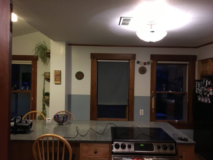

  1. JC72 | | #1
    Not surprised by the results but still interesting. When the cook top is on an island the hood definitely needs to be have a 6 inch over-hang on each side due to the cross currents. In addition 36-inches from the cook surface is typically considered the maximum height .
    Peter Engle | | #2
    I noticed the minisplit on the wall, pointed right at the range and hood. It would be interesting to see the same setup with the minisplit operating.
      Peter Yost | | #6
      Interesting catch Peter.
      Alex noted during the testing that they must have the mini-split off when they use the range hood; it's just too disruptive to hood capture when the mini-split is on.
      Sorry we did not test with it on, though...

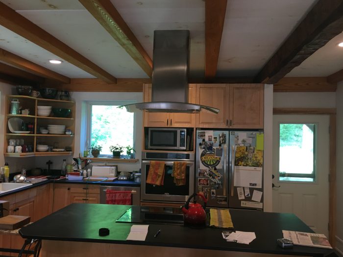

    As pointed out in the text, the experimental setup doesn't much mimic real-life cooking fumes. It's not even close. The splatter and smoke coming off the cooktop is typically rising straight up, with very little horizontal velocity, with toroidal convective looping induced around the rising column of hotter gases.
    Spraying fog from the side at 5-10 feet per second is just silly- there isn't a lot meaningful information to be gathered there. Running the experiment by heating something in a pan in on the cooktop to create the fog/smoke would be more relevant, since it would introduce the same convective forces in magnitude & direction as when cooking.
  7. Expert Member
    Peter Yost | | #10
    The reason I moved the fogger 5 feet away from the center of the cooktop and fogged only a 5 second burst was to have the "slug" of fog drift and slow as it crossed the cooktop. The fog's velocity was not constant as you imply.
    Sorry you feel that no meaningful information was gathered; I still think that we got useful info from the test. I certainly agree that the test could be improved and made more meaningful. Many of my wingnut tests improve over time as critiques are offered. Thanks for yours.

    Peter Engle | | #11
    I was thinking along the same lines as Dana. Besides the horizontal velocity, you don't have the rising column of heated air and smoke that naturally comes off of the stove and pan. That's going to deliver the smoke far more efficiently towards the hood and somewhat encapsulate it with entrained air around the margins of the rising column.
    I haven't got time to test it myself right now, but the juice that makes the smoke would probably make perfectly good smoke if placed in a hot pan on the stove. If you added a measured amount, you could probably get a pretty well-controlled shot of smoke that would be entrained in the heated air column rising from the pan. Seems like that would be more representative of real-world behavior.

  9. rockies63 | | #13
    I'd be curious to see the amount of grease that builds up on that light fixture after a few dinners. I must admit I've never seen a ceiling mounted grill used as the range exhaust intake. I'm sure it's designed to be one, I've just never seen that before.
    It reminds me of a lecture I attended 30 years ago on the evolution of the fireplace and they showed a slide of a large banquet hall that had a central fire pit and a hole in the roof overhead.(it was from the 12th century I believe). The next slide showed how the invention and inclusion of a chimney and moving the fire to an exterior wall improved the indoor air quality (maybe 13th century).
    Did you design/build this kitchen with this intake grill or did the house come with it?
      Peter Yost | | #15
      Interesting Scott. When you move a fireplace from a central location to an exterior one, at least in cold weather, you lose quite a bit of stack effect. Lots of gable-end fireplaces have draw problems while the old center hearth ones don't.
      To say that I designed our kitchen exhaust system is definitely an overstatement. I admit I treated it pretty much like a bath exhaust fan and it was what we could afford. But it seems to do the job.
      In the videos of my kitchen exhaust, particularly near the end, if you look closely or zoom in, you can see the fog rolling off the bowl of the light and into the grille of the exhaust. We really don't clean that light much more than once a year. I suspect that having both the light and the exhaust up at the ceiling level means less airborne grease actually makes it up to either.
      Peter
