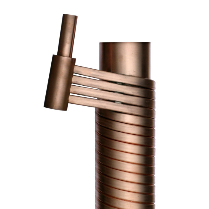

The Power-Pipe drainline heat exchanger is a large-diameter drain pipe surrounded by a coil of water supply tubing. Heat from the hot water going down the drain pipe is transferred to water passing through the smaller diameter tubing.

How a drainline heat exchanger works
The process is pretty simple. A special section of copper drainpipe is installed beneath a shower (typically the largest hot water use in a home) or other hot wastewater source. This section of drainpipe has smaller-diameter copper piping wrapped tightly around it. The cold-water supply pipe leading into the water heater is diverted so that it flows through the small-diameter copper pipe.
When hot water is being pulled from the water heater to supply the shower, the water going into the water heater is preheated by the wastewater going down the shower drain. If it’s a tankless — rather than storage — water heater, the incoming water temperature will be higher, so less energy will be required to get it up to the needed delivery temperature — thus saving energy (though the tankless water heater has to be thermostatically controlled and, thus, able to deal with inlet water of varying temperature).

There are four manufacturers of drainline heat exchangers that I’m aware of: Vasile’s original company, WaterFilm Energy of Medford, New York, and three Canadian companies: EcoInnovation Technologies of St-Louis-de-Gonzague, Quebec, which makes the Eco-GFX; ReTherm Energy Systems of Summerside, Prince Edward Island; and RenewAbility Energy of Kitchener, Ontario, which makes the Power-Pipe.
Most of these have a single 1/2-inch copper pipe coiled around a length (typically three to five feet) of 2-inch or 3-inch diameter drain pipe.
The Power-Pipe is a little different than the others. It has a header that splits the supply pipe into four smaller, square-cross-section pipes that provide more surface area for heat transfer.
Most of these manufacturers offer various lengths and diameters of drainline and can accommodate different supply pipe diameters.
