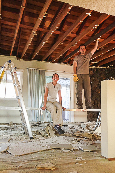

Demolition of the common area
The idea was to take off the drywall in big sheets by trying to find the seams and pulling the nails out rather than just smashing it all apart. But as we were very much amateurs, we often ended up just smashing it apart. Wen and her brother Bin helped take out the ceiling.
We got the living room ceiling out after several hours of work. For me this was the first of many, many long, hot, sweaty days. Next came the decidedly less fun and exciting process of shoveling up hundreds of pounds of drywall first into a wheelbarrow, and then into a huge dumpster (see Image #4 below).
The dumpster gradually got more full. But it was still only about 75% full when they picked it up — not the most efficient use of an expensive resource.
A lot of the equipment I bought can be used throughout the project, so it can be considered an investment. The dumpsters, however, I did not use efficiently enough. I underestimated just how how laborious the demolition would be, and struggled to fill the 30 cubic-yard dumpster by myself within the seven-day rental period. I overworked myself that first week, so much so that the next week I needed a few days to recover and couldn’t work. I learned later that I could have just extended the dumpster another week at no charge. I guess the lesson is to know what your options are and to be realistic and conservative about what you can get done within a certain time period, especially when you haven’t done it before and uncertainty is high.
For some reason, there were no volunteer helpers for the cleanup part or any of the subsequent days of demolition. In any case, I pressed onward. After cleaning up the living room somewhat, I moved on to the kitchen. Also to be removed was the forced-air heating and cooling system of the house. We will be without central heating and cooling until I install the new heat pump system. We either donated or recycled the appliances.
