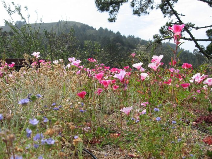

We have a wee living roof on our home. After a couple of false starts, it’s looking quite winsome. Since it has posed a number of challenges, I thought I’d share our experience. Mistakes, after all, are more instructive (and entertaining) than successes.

It was a while after the whole project was done before I got around to planting—it’s been about two years now. I purchased a bunch of sedum (four varieties) from Rana Creek, now famous for the living roof on the new LEED Platinum California Academy of Sciences, and planted them with help from my neighbor Dawn and our kids. Then I seeded with California native annual and perennial wildflowers and grasses from Larner Seeds. Then I watered, then I waited.
As it happens, I didn’t water enough, and I waited too long.
We had planned to install an automatic timer on the irrigation system but hadn’t gotten around to doing it, so I had to activate the system manually. In general, my garden policy is one of benign neglect. In this climate, if you’re not drought tolerant, you will wither and die pretty quickly if you’re in my garden. Even though the roof garden was right under my nose, I’m sorry to say that it was no exception.
I can now attest that sedum is, as billed, extremely drought-tolerant, albeit slow-growing. I don’t think I lost a single one. All the wildflowers and grasses I’d chosen were also drought tolerant—but they did require moisture to germinate, and that’s the part I muffed. I tried, mind you. I’m just a lousy plant parent. (This is why I don’t have many plants in pots: They really must have access to a scintilla of moisture in the ground if they’re to have a prayer of surviving.)
Take 2
After several months of good intentions and seriously flawed follow-through, I reseeded. This time I was a bit better about the watering, and got some wildflowers going. Not a stunning crop, but enough to cheer me considerably and alleviate my sense of shameful negligence.
I should mention that not all of this was my fault. There was a conspiracy to thwart me on the part of my irrigation system. It was finicky. In fact, for a long time I thought it was broken. After the first planting, I succeeded in getting it to deliver water only a couple of times, then the valve—mysteriously—failed to produce water. So I resorted to hose-watering. This is what really foiled me. If maintenance is not easy, I confess to being easily deterred; there are too many other maintenance tasks that demand my attention but don’t represent such a challenge—laundry, for instance. I can pretty much do laundry in my sleep (which is a good thing).
I talked to Bill about the @#$#% valve, and he suggested that I take a closer look at it; perhaps it just needed a tweak. I tweaked, with no luck, and another few months went by with me watering sporadically. Then one day when I could no longer remember all the details of my challenges with the @#$#% valve, I resolved to have another look. So look I did, and tinker, and lo and behold, the valve cooperated—and has ever since.
Go figure.
Third time’s the charm!
Having conquered the watering challenge (lame as it was), I seeded for the third time, and watered somewhat diligently. I also enlisted the help of my gardener, who up until that time had no responsibility for the roof. I’m quite prepared to admit that his attention is probably what turned the tide. And so we now have a roof full of vibrant color, well into its second spring. The grasses have been slower to start than the wildflowers, but they’re coming along nicely. I had a fair amount of lupine last summer, and I’m hoping we’ll get some repeats. My first batch of California poppies for the year bloomed a week or so ago, and we have a couple of varieties I don’t remember from last year.
All in all, I’m quite pleased with the view.
  1. lightsourceon | | #1
    Lupine consideration
    I distinctly remember in my green roof certification course the mention of lupine being used as THE plant to test for failure of root barriers - it apparently has one of the the most invasive root systems around.... you might consider encouraging a different flowering species.
  2. Ann Edminster | | #2
    Lupines
    I hadn't heard that -- thanks for the tip! (Darn it, I love lupines; they don't seem to be resprouting this year, so perhaps it's taken care of itself.)
