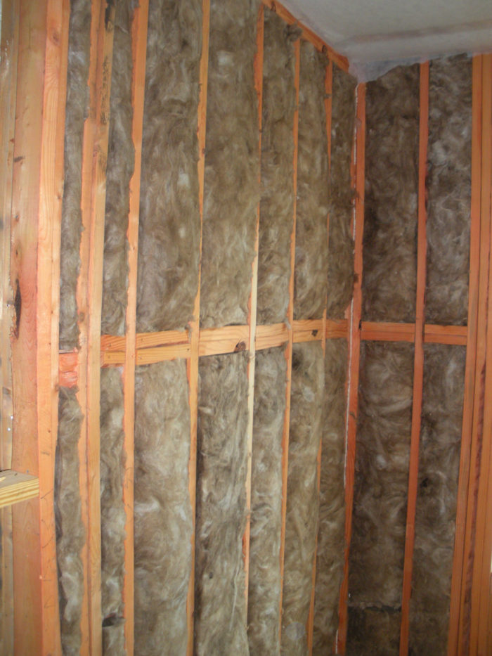

Seeing insulation of this quality practically brings tears of joy to my eyes. If only it happened more often. With some coaching, we were able to get the project team to understand why and how chases such as these needed to be air sealed, and they got the work done. This chase was identified on site as not being properly air sealed. Batts were placed in the wall without the necessary air barrier. Finding these issues on site is critical to assuring a complete building envelope. This is the drawing of the chase pictured above. All our projects start with a detailed drawing review pointing out potential issues to both the architect and the contractor. The next step is to have the drawings include necessary details and for them to be incorporated on site. Although the installation on this project was generally excellent, there were still the occasional lapses. This cavity had the insulation properly split below the purlin, but not above.

The installers are proud of their work and it shows. The batts are consistently cut properly to fit the wall cavities, and are (mostly) split around wires and pipes. Interestingly, during a recent inspection, I pulled back some batts around plumbing drains to find the lower section split properly while the top section wasn’t. I find it hard to understand the thought process behind this type of inconsistency.

During our initial walk-through prior to the start of insulation, we identified several chases on each floor that required additional air sealing. The construction team was not aware of these energy code and NGBS requirements. Although the city building inspectors don’t seem to enforce them, we do.
The team installed drywall in the chases to provide the required air barrier. We recently invited the architects to meet with us on site to discuss some of the air sealing details, providing them feedback on how they can better document them on future projects.
