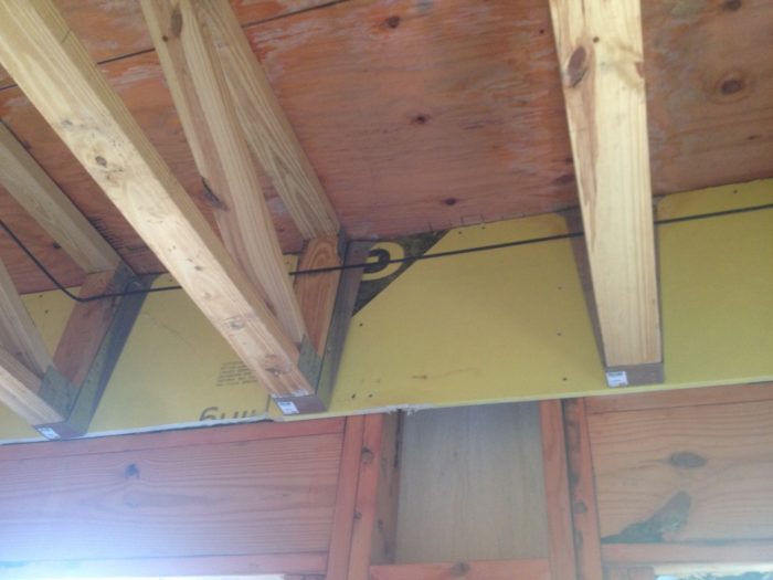

Oops! We forgot to insulate. The builder needed to install gypsum sheathing to fill a gap before installing the floor joists. Unfortunately, this approach left large uninsulated gaps that will need to be blown in later through drilled holes.

Pulling back one piece of insulation exposes a large chase that is not properly air sealed at either the exterior walls of the chase or at the outside surface of the interior wall. These details should be better identified on the plans. The gable at the end of this vault is an attic kneewall that requires rigid air barriers on both sides and R-18 insulation. Neither the architect nor the contractor were aware of these code requirements. No matter how often we are told that the insulation installers know how to install insulation to Grade 1 specifications, this is what we see on almost every project. Identifying chases such as these in the design and estimating phase, and budgeting for appropriate air sealing from the beginning, will reduce delays and job site tension

Depending on the certification program (we work with LEED for Homes, the National Green Building Standard, EarthCraft, Energy Star, and Enterprise Green Communities), we have to confirm that insulation installation meets either Grade 1 or Grade 2 specifications for these projects to be certified.
In our initial meetings, we stress the importance of this, and urge our clients to consider something other than batt insulation due to the challenges of meeting the installation quality requirements. Unfortunately, the budgets rarely allow for these upgrades, so we constantly find ourselves struggling with the installers.
We always schedule a meeting before insulation work starts to review our requirements and to confirm that the installer can meet them. This is the point at which we start hearing the falsehoods. The managers always insist they have great crews who are fully trained to meet the Grade 1 standard, but inevitably when they show up on site, no one has discussed installation quality with them and they just start doing their regular old Grade 3 work.
I can’t blame the installers (at least most of the time), as many are paid on a piece-work basis and in most cases, they are not only not being paid enough for the quality work we need, chances are they were never told that the job required Grade 1.
Whole lotta firing going on
Our enforcement of insulation standards leads to a lot of friction on the job site. When you walk through a job and pull out about 80% of all the insulation for correction, you get some pushback.
Insulators complain that they aren’t being paid enough, builders complain that we are delaying their schedule, and we complain because we get all itchy from touching insulation all day. We have caused insulators to quit and get fired, and we have even been fired as consultants from a project because the builder blamed us for their delays.
The part about this that bothers us the most is that while we are enforcing green building standards, typically these standards are no more stringent than the energy code and the insulation manufacturer’s instructions. These instructions call for the equivalent of Grade 1 and all necessary air barriers.
Unfortunately, the baseline we are compared to is so far below these standards that many builders cannot easily get to where they need to be.
