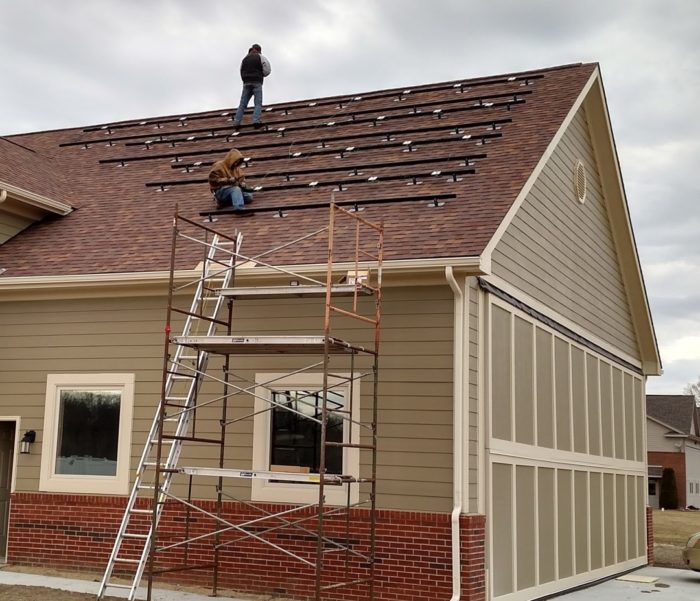

Our PV array includes 28 Suniva panels [according to published reports, the company has since filed for Chapter 11 bankruptcy]. Each is rated at 280 watts, for a total of 7.84 kW. The system was installed by Homeland Solar. The installer sized the system based on our electric bills since we moved in last September. We reduced the size a bit from their estimate because we really do expect to do better on electric usage in the future. For aesthetic reasons, we decided to go with the all black panels even though they produce slightly less power per panel than the silver panels.
First the rack, then the panels
The first step was to set up scaffolding to safely get up on the roof. Then, the support rails are attached to the roof. After the rails are in place, panels are installed.
DC wires run from the panels on the hangar roof, through the hangar attic and the hangar, into the basement. The Solar Edge 7.6 kW inverter is installed in the utility room. Although the inverter is a few feet away from the electrical panel, the AC wiring cannot take the direct route. The utility requires an exterior shut-off switch near the electric meter.
In most homes, the electric meter is close to the electrical panel, but not in ours. Fortunately, in anticipation of eventually installing a generator, we had the foresight to install a conduit from the utility room to the end of the house with the meter. The installers were able to pull three sets of wires through the conduit: one from the inverter to the shutoff switch, one from the shutoff switch to the electrical panel, and one for the eventual natural gas standby generator.
The installed cost came out to $2.55 per watt ($1.79 after the 30% tax credit). Our monthly payments under the Michigan Saves loan will be a little bit more than the expected reduction in our electric bill, so the project is not quite cash flow positive in the first year. If electric prices go up, we will be ahead. In 10 years, the loan will be paid off, so we will be saving money even if the net metering terms are not as favorable.

    MALCOLM TAYLOR | | #1
    Reid
    The finished panel install looks really good on the roof. Who are those shifty guys in their hoodies without fall protection? Lucky OSHA wasn't around!
