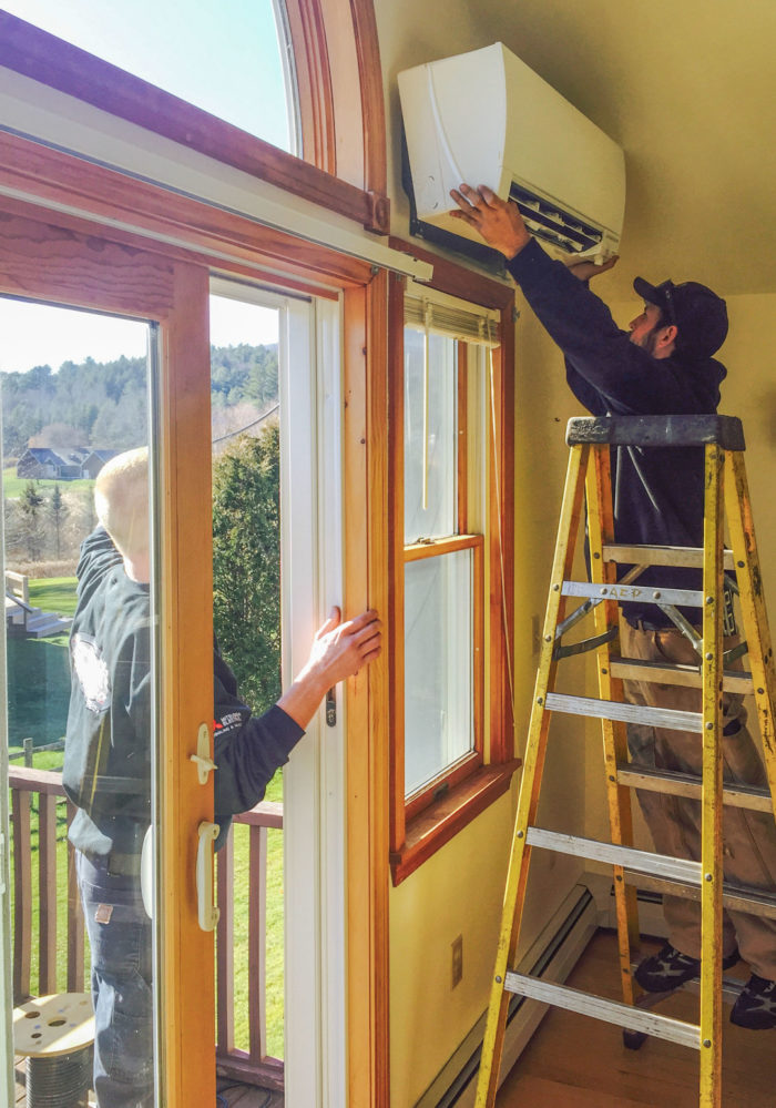

Green Mountain Power is broadening its pitch for ductless minisplit heat pumps, telling consumers they can reduce heating bills by as much as 50%. The program is now offered in every area the utility serves.
Image Credit: Green Mountain Power
Vermont’s largest electric utility is beefing up its campaign to get ductless minisplit heat pumps into the homes of more people as it expands its no-money-down pitch to consumers in its entire service area.
Homeowners who sign up get a heat pump from one of three manufacturers and finance the cost of the installation over 15 years, making loan payments from $49 to $81 per month for a single-head heat pump. There is no down payment, and Green Mountain Power says that heating bills in this Climate Zone 6 state can be reduced by between 25% and 50%. Maintenance is included.
