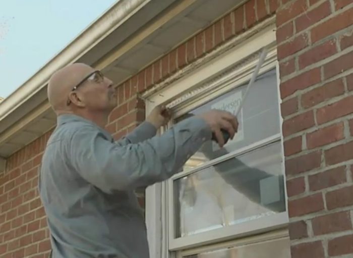

In a 4-part video series, Mike Sloggat explains how to inspect existing windows and, if appropriate, install an insert replacement window in a brick home
Mike Sloggatt has thirty years' experience working on brick houses. In this four-part video series, Mike shows all of the steps required to install an insert replacement window in a brick home.
Brick walls can seriously complicate window installation and can sometimes confuse even the most experienced builders. Fortunately for us, Mike Sloggatt, who has thirty years’ experience working on brick houses, was available to show us how to assess the situation and do the job right.
In this video series, Mike will demonstrate how to:
  • Inspect the condition of the existing window to determine if it is a good candidate for a new insert window.
  • Measure for a new insert window.
  • Shim, level, and fasten the insert window.
  • Air-seal between the new unit and the jamb of the original window.
  • Install interior and exterior trim.
