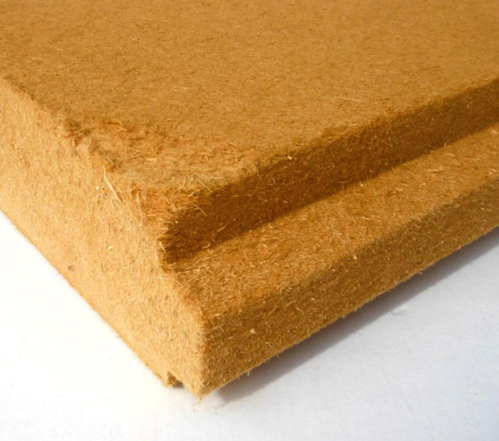

Agepan wood-fiber insulative sheathing is now being sold by the Small Planet Workshop.
Image Credit: Small Planet Workshop

Wood-fiber insulation from Germany
In Europe it is becoming increasingly common to use high-permeability wood fiber sheathing as an exterior insulation material, and at least one such material was on display at the conference. The Small Planet Workshop in Olympia, Washington, is now distributing the German product Agepan THD. These 2-inch-thick panels insulate to R-5.7 (R-2.3 per inch) and have a high perm rating of 18 — meaning that water vapor can pass through them fairly easily.
It’s hard to say whether wood-fiber insulative sheathing will gain followers here, but there is growing interest in wall assemblies that won’t trap moisture, so products like these are worth keeping an eye on. The Small Planet Workshop also distributes the expanded-cork boardstock insulation that I’ve written about previously and that I’m planning to use on my own house in Dummerston, Vermont.
