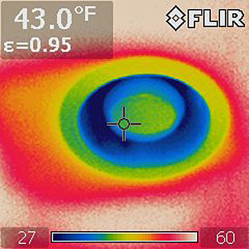

This thermal image shows a recessed light in a house built in 1994. The blower door test showed that the house had an air leakace rate of 5,750 cfm50. Unless you are testing the Astrodome, that result is quite high. On the day of the test, the outside temperature was around 10°F. You can see that the temperature inside the can is 27°F. Bad, bad, bad.
Image Credit: Erik North
One hates to overstate how problematic recessed lights can be, but… they sure are a pain in the energy-auditor butt. There are worse problems (wet basements), more expensive ones (insulating a complicated roof line), and more frustrating ones (the cross-purposes of energy evaluations and homeowner desires). But few elements of the house combine all three in as tidy a package as recessed light cans.
Recessed lights can be an problem. A large, incredibly leaky problem. Of the 10 worst blower-door numbers I’ve seen in newer houses, all 10 involved recessed light installations. A lousy blower-door test means loads of conditioned air escaping the house and uncomfortable homeowners.
Fixing recessed can air leaks can either be an enormous project or an actually impossible project. You would either replace all the cans with airtight ones or build drywall boxes from overhead. Oh, wait? You don’t have access to the recessed cans?
And good luck if they’ve been installed in a cathedral ceiling.
The final hurdle is that there’s a good chance that your customer likes them. You’ve tromped around for three hours, waved your thermal camera about and calmly declared that the homeowner’s sleek modern recessed lights are a big problem. It will always be a difficult conversation.

    The thermal picture also illustrates the lack of insulation above the light... and perhaps inadequate insulation in the ceiling itself.
    How about some thermal pictures of in-contact / air tight recessed cans that were installed correctly and have insulation over them. The picture is not likely to be as dramatic...
