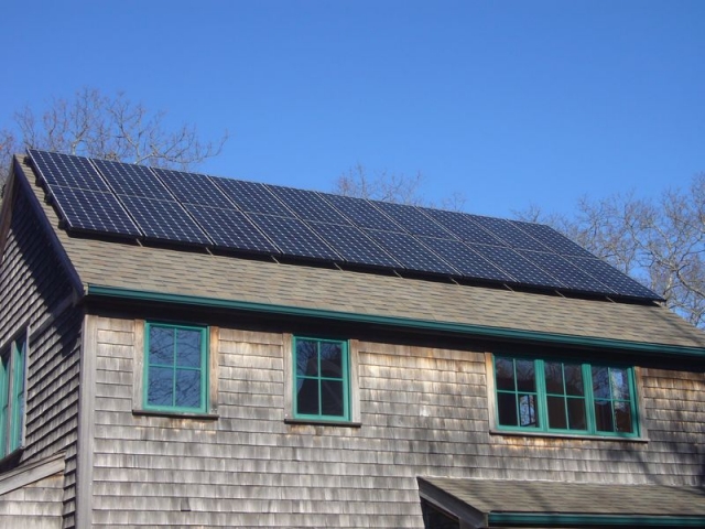

Marc Rosenbaum has a 4.8-kW photovoltaic array on his roof. The Massachusetts house is grid-connected.

One thing I learned while following the energy usage of buildings I designed was that as a building’s energy needs are reduced, and the fraction of those needs supplied by solar energy increases, the variation in backup energy (purchased energy) increases from year to year.
Let’s look at the monitoring data for our house, and compare the winter of 2011-2012 with the winter of 2012-2013. Due to colder weather and changing lifestyles, we used 23% more energy over these months in 2012-2013 than in the previous year.
First, we’ll look at the variation in heating load. This winter (November to February) has been 20% colder than last winter.

Meanwhile, it’s been noticably cloudier this winter, so PV production over the four-month period is down 22% compared to last year.
PV Production
Consequently, while our net imported energy last year over this period was 18 kWh, this year it is 45 times higher at 804 kWh.
Net Imported Energy
Manage client expectations
If you design or build zero-net-energy buildings, it’s important to communicate to the owners that these year-to-year variation are significant. Manage expectations!
Beyond a certain baseline, how much energy they use for plug loads, appliances, and lighting is under their control. How much they use for hot water is similar.
At a given thermostat setting, how much energy they purchase for heating and cooling depends on the weather and the amount of sun available, and how much a solar electric or solar thermal system generates depends on solar availability and how much of the time the collectors are covered with snow.
To reach net-zero during cloudy years, you’ll have to oversize the PV array
If you want to be pretty certain that a building is net zero every year, the solar electric system probably needs to be oversized by close to 30% (a SWAG). Driving the building’s heating load down will make this variation smaller, by making one weather-dependent factor smaller.
