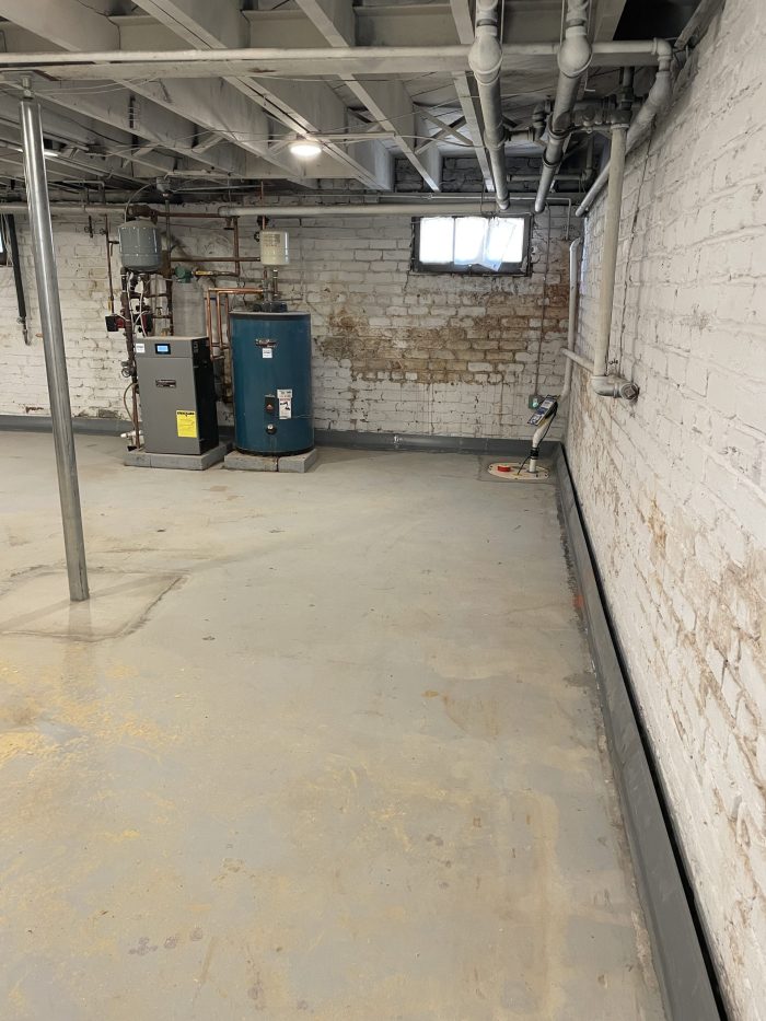

This article will focus on ways to fix a damp basement so that it’s dry enough to use as indoor living space. Before tackling that topic, though, I’ll briefly outline the steps used during a new construction project to keep the basement dry.
Remember: fixing a wet basement can cost tens of thousands of dollars. It will never be easier to get the details right than when a home is first built; spending a few hundred extra dollars now can save thousands later.
If you are building a new home, and you want a dry basement, you should specify:

  25. anonymoususer | | #31
    Quote for excavate around existing firldstone basement
    We want a quote for excavating around our Victorian-era fieldstone basement, insulating, parging. Anyone know a contractor near MA-NH-VT intersection we can get quote from? A decade ago an excavator graded earth downward around whole foundation. We tried pointing gutter downspouts far far from foundation. We had a “basement waterproofing” contractor dig full interior perimeter then install drainage pipe, dimple flange and electric sump that empties to daylight. Another contractor painted interior face of fieldstones with elastomeric. We run high capacity dehumidifier constantly. Eaves and rakes have no overhang but we are in process of correcting that. We now need additional home office space yet are stuck with a wet dungeon in our “forever” house. We dont even know what terms to google: “excavation/foundation contractor”? Anyone know anyone who does the work we need?
  26. brooklynite2 | | #32
