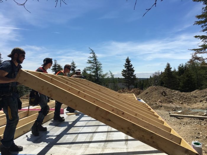

We started framing! We hired a local company, KeoCan, owned by Patrick Keogh. They were keen to take on our job and we were happy to get started. Having a poured floor to work on is a luxury to these guys. Normally when they start framing there is nothing but foundation walls to work on.
The exterior portion of the thermal envelope is pretty conventional: a 2×8 stud wall framed at 24 inches on center. This is as advanced as it gets. Although framers here have lots of conventional experience, there is little to no advanced framing experience in the residential construction industry. This is unfortunate since using fewer studs decreases costs and also saves energy and resources.
The battle in my head on this has been won… and lost. Using my house as an experiment for OVE [optimal value engineering] framing would probably use up more energy in headaches than the energy savings I would gain! I figure it is a win/lose (or lose/win situation) whichever way you look at it.
Seriously though, I took some time to analyze the R-values. The wall is composed of 1/2-inch spruce cladding, a 3/4-inch air space, 3 inches of Type I EPS, 2×8 (24-inch o.c.) stud wall filled with R-31 fiberglass compressed to about R-27, OSB (our air barrier), R-15 fiberglass batts in a 2×4 service wall, and gypsum wall board. The calculated R-value is about 49.88 according to this great little calculator. Changing the exterior 2×8 stud wall to 16-inch o.c. emulates an increase in the stud fraction and gives an R-value of 48.95. The U-factors for these assemblies are 0.0200 and 0.0203 respectively.
Another way to look at this is that heat transfer rate has been reduced by 98% or 97.97% respectively. This illustrates a point. Adding a few studs here and there to keep your framer and the local officials happy is no big deal. It needs to make sense, of course, but adhering to local practices may not be the end of your energy-efficient building. If window headers require double jacks, then double jacks it is… (If there are any questions, you should contact your Passive House consultant.)
The walls on the main level are all 9 feet high. Since 2×8 lumber is not a conventional wall building component, pre-cut lengths aren’t available. This means that 10-foot lengths have to be cut to the proper size. This leads to some waste, but since it’s all kiln-dried softwood it will make for great fuel in my Walltherm wood stove this coming winter. It’s not a great use of lumber, but at least it won’t be thrown in the landfill.
Being in a windy location means that the structure needs bracing, bracing, and more bracing. Windy is normal here. When the sun comes out, it’s windier! The wind speed reached a sustained 50 km/hr (31 mph) yesterday. Today the weather is forecast to be sunny and 26° Celsius (79°F). The wind speed today is expected to gust at 70 km/hr (43 mph) by 6 p.m. Bracing the walls has been a bit of a challenge since there are not very many places to brace from.
