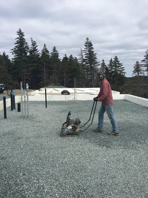

To minimize settling, the layer of crushed rock beneath the slab was compacted prior to the pour. This view shows the author working on what will be the main floor of the house.

After backfilling and infilling the the frost wall foundation, we tamped the fill material in hopes that it would reduce settling and therefore cracks in the slab over time. These compactors are quite effective. Material which would seem to be solid starts to collapse as the compactor moves over the ground.

While the slinger operator was able to distribute the stone fairly evenly, we still had to spend some time making sure the surface was level. We strung a series of lines across the foundation from side to side. Using shovels and a landscaping rake, we leveled the stone under the lines to match the height at the edge of the foundation.
As we compacted the stone, we raked out high spots and added stone to low spots, checking the depth as we went. After compacting, it was on to foam. The slab has one load-bearing wall, which supports the second floor but not the roof. To keep things simple we added a thickened slab under that wall, which will be reinforced with rebar. Under that “footing” is 6 inches of Type III EPS which has a higher compressive strength than the Type II EPS used on the foundation and under the remainder of the slab.
