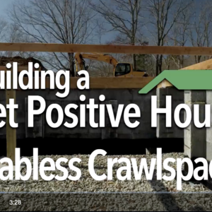

Installing foamed glass aggregate
On this project, the crew started the foamed glass installation at the bottom of the footing. The as-built detail above reflects a lowered elevation for the foamed glass—a response to the decision to create more headroom in the crawlspace, which will measure 4-ft. 6-in. in height and house the mechanicals.
The material goes down in 6-in. lifts, and each lift is compacted. There is a compaction factor based on the application and R-value objective. In this case, it was 1.37, which means if you put down 1.37 in. of product, the ideal compaction is to an inch. Here, they laid down 7 to 8 in., then compacted down to about 6 in., adding subsequent lifts.
Before the foundation walls go in, the compacted aggregate sits flush with the top of the footing, providing a flat surface for the crew to set the foundation walls. Once the walls are in place, they add another 6 in. of foamed glass for a total of 18 in. For the top inch, they use 3/4-in.-minus AeroAggregate, compacted and top-dressed with sand. (Because there is no concrete slab nor a plywood cover, the final surface needs to be as smooth as possible to receive a vapor barrier, which is the only material going over the aggregate.)
For installation, two or three bags are lifted with a forked loader and moved to where the excavator is sitting. The operator swings them into position, one at a time. The bottom of the bag is cut open and the operator works to evenly distribute the material throughout the foundation. Then it is hand-graded and machine-compacted.
