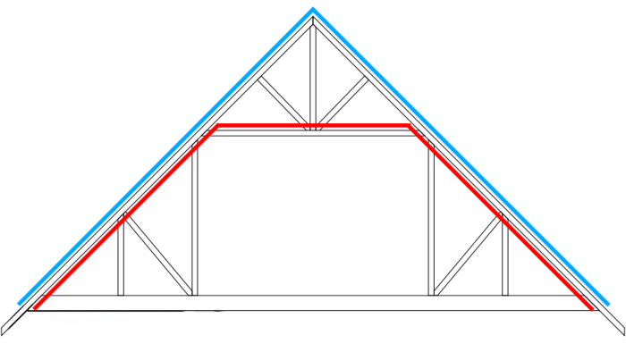

In a traditional house with a gable roof, attics were usually vented and unconditioned, with insulation installed on the attic floor.
These days, however, builders often choose to install insulation that follows the sloping roofline. The reasons for this trend are many:
  • This approach can be used to create an unvented conditioned attic, allowing attic ducts to be installed inside a home’s thermal envelope.
  • Many modern designs include cathedral ceilings, and cathedral ceilings need insulation that follows the roof slope.
  • In a Cape Code house, or any house with a half story on the top floor, insulation should usually follow the roof slope.

  19. johnnydc | | #42
    Martin, thanks as always for the clear and helpful write up. This is something I'm pretty determined to do, and your article is incredibly helpful.
    My main concern is: how do you think that this works with the solar arrays? I have solar panels now, and I'm wondering if your experience tells you that there is some helpful way to make sure that when the solar goes back on, the installers don't just punch hundreds of holes into your sheathing and insulation while looking for the rafters. My friend does solar installation for a big company, and his stories do not reassure me about the care and precision with which his colleagues work! Even in the best of circumstances, they miss rafters and have to patch the holes, and if you get somebody who is careless or incompetent, the situation can be worse.
    Your advice would be most appreciated.
