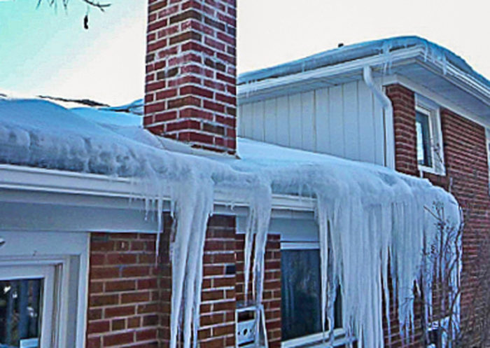

As the biting cold of winter hit the Great Lakes area last December, many building owners started to see signs of moisture damage on parts of their walls and ceilings. As we keep indoor temperatures consistent while the outdoor temperature drops, the difference between indoor and outdoor temperatures (the ole’ Delta T, as they call it) becomes greater. This difference pushes indoor air upward; if there are leaks in the ceiling, the air goes up and out and into the cold attic space. That’s the stack effect — slightly less powerful than the force Darth Vader uses, but equally nefarious.
The summer’s high humidity is stored in the mass of our buildings. As fall comes around, the stored humidity is released as the indoor air’s humidity drops (which happens when the cold, dry winter arrives). In early winter, humidity levels indoors are high, and it’s common at the first bite of winter to see signs of attic condensation — or even condensation in the living space.
If not promptly remediated, this combination of factors is destructive. Usually by late January the store of humidity in the house has dropped as air is exchanged intentionally through mechanical ventilation systems or unintentionally by uncontrolled air leakage through poorly sealed building enclosures. The stack effect drives conditioned air out of the living space and often introduces the moist air into spaces that can’t handle humidity (because attic voids are cold).
The cold attic quickly converts the water vapor to water in a liquid or even solid state. Either way, water in liquid or solid form isn’t desirable in closed attic spaces. Though some large-volume, well-vented attics can handle a bit of heat and humidity, small-volume attics often can’t handle the moisture. They start to show signs of deterioration more quickly.
