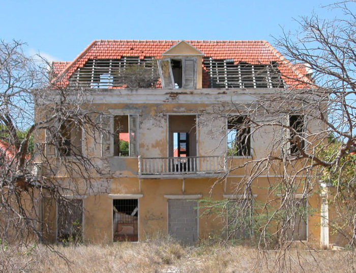

The walls and roof of this house breathe — but you probably wouldn't want to live here. (Yes, we know that most builders who talk about "houses that breathe" have something else in mind.)
