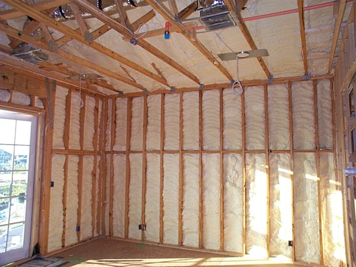

Closed-cell spray foam is now available with an environmentally friendlier formulation. A new blowing agent means the insulation contributes less to global climate change than the chemistry most other manufacturers are using.

Reformulated versions of spray polyurethane foam with only a tiny fraction of the global warming potential of their predecessors are getting easier to find.
Texas-based Demilec, a manufacturer with distribution in both the U.S. and Canada, is among those offering a medium-density closed-cell spray foam made with a hydrofluoroolefin (HFO) blowing agent, the next generation of chemistry for the industry. Similar products are here or on the way.
Blowing agents are essential ingredients in spray foam insulation. They create the tiny bubbles of trapped gas that slow the movement of heat and make foam such a good insulator. But the most common blowing agent in spray polyurethane foam today, a hydrofluorocarbon, has a global warming potential (GWP) more than 1,000 times that of carbon dioxide. The HFO Demilec and others now offer — a chemical made by Honeywell called Solstice Liquid Blowing Agent — has a GWP of 1.
