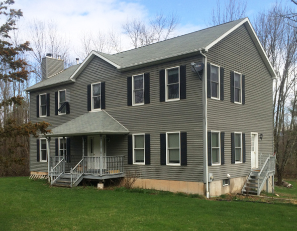

This six-year-old home in upstate New York has mold in the back of the closets.

Client: The mold is oddly only in certain closets and always down low, fading and thinning as you move from the baseboard up to about two or three feet (see Image #2, below).
Pete: The only practical way of getting rid of the mold is to manage moisture. I can help, but almost certainly I need to come and assess your home for moisture problems.

I drive up, and after introducing myself, immediately start walking the site looking at and taking pictures of bulk water management (see Images #3, 4, and 5) on the outside of the home. (It had rained long and hard the night before I showed up.).
Client: Why are you starting on the outside? The mold is in here.

Pete: OK, it’s finally time to look at the mold.
Client: It’s funny, but the mold is in these three closets. It’s mostly these two on the first floor and then a bit of mold in the upstairs hall linen closet.
Pete: Huh — all three are along the central partition of your house. This is a modular home, isn’t it? (See Images #9, #10, and #11).
Puzzle solved?
Pete: Your home has high levels of moisture pretty much on all levels. In the winter, cold air is leaking in at your basement rim joist and being pulled up the home’s marriage wall, which — with just that fiberglass insulation — forms a highway for air to leak from basement to attic.
The first-floor mold pattern is caused by the cooler basement air bringing the surface temperature of your gypsum wallboard down below the dew point so that condensation forms. But as that cold air travels up, it gets warmed and the mold fades.
I think the mold in the upstairs linen closet (which is much less pronounced) is caused when it’s really cold and your wood boiler is going full tilt with the combustion air it needs pulling cold air down from the attic on occasion.
